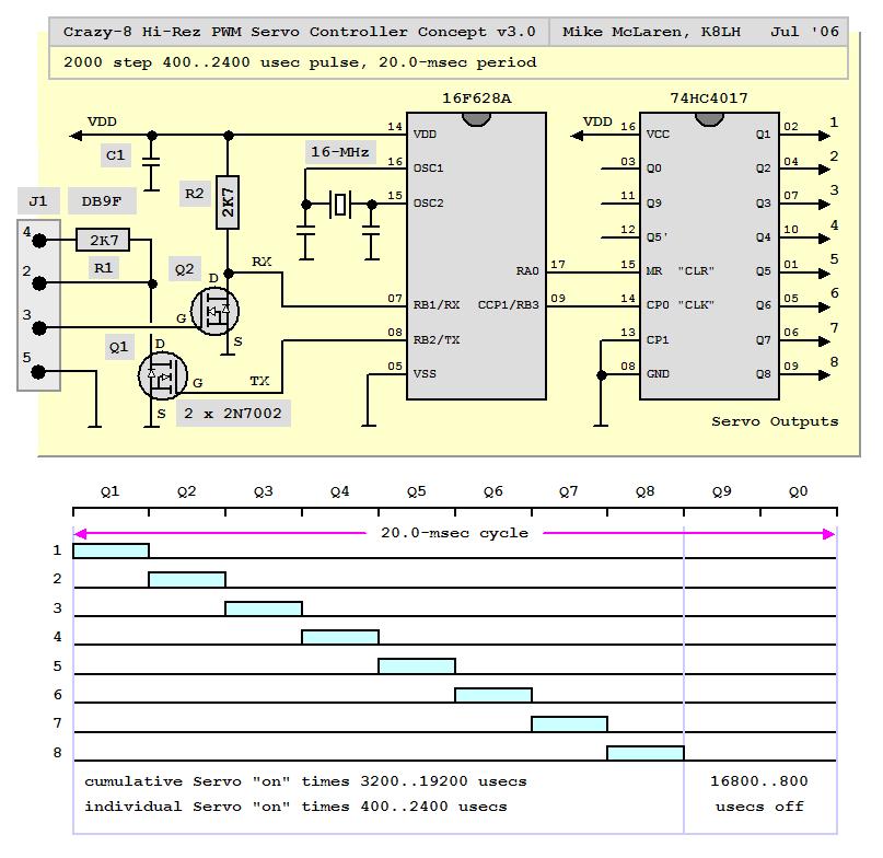

I worked out a couple concepts awhile back from ideas proposed by another Forum member but they require an extra chip (a 74HC4017 Johnson ring counter or a 74HC238 decoder).
Both use the CCP module in "compare" mode to provide 8 rock solid hi-rez' no-jitter servo outputs with a 20-msec period. The 74HC4017 version could also provide 9 outputs with a 22-msec period.
Since the '877A has two CCP modules I suppose you could connect two 74HC4017 devices for 16 or 18 servo outputs but I have not worked out an algorithm or code to support that.
While the processing "overhead" for this scheme is incredibly light, I'd still consider off-loading Servo control to a little 12F683 / 74HC4017 board with crystal and simple serial interface and command structure.
I hope you don't mind the different idea. Good luck with your project.
Regards, Mike
Here's the ISR "engine" for the 74HC4017 version of the Servo controller;

;  Qarray holds ten 16-bit period values, one for each of the
;  ten shift register Qn outputs.  Eight Qn outputs and periods
;  drive Servos.  The other two Qn outputs are unused but their
;  periods are used to complete a 20-msec Servo cycle.
;  Qarray(0) is Q1 Servo 1 "on" time, 400..2400
;  Qarray(1) is Q2 Servo 2 "on" time, 400..2400
;  Qarray(2) is Q3 Servo 3 "on" time, 400..2400
;  Qarray(3) is Q4 Servo 4 "on" time, 400..2400
;  Qarray(4) is Q5 Servo 5 "on" time, 400..2400
;  Qarray(5) is Q6 Servo 6 "on" time, 400..2400
;  Qarray(6) is Q7 Servo 7 "on" time, 400..2400
;  Qarray(7) is Q8 Servo 8 "on" time, 400..2400
;  Qarray(8) is Q9 unused cycle time, 400 (fixed)
;  Qarray(9) is Q0 end-of-cycle time, 400..16800
;  add current Qarray(Qn) period to previous CCPR1L:CCPR1H
