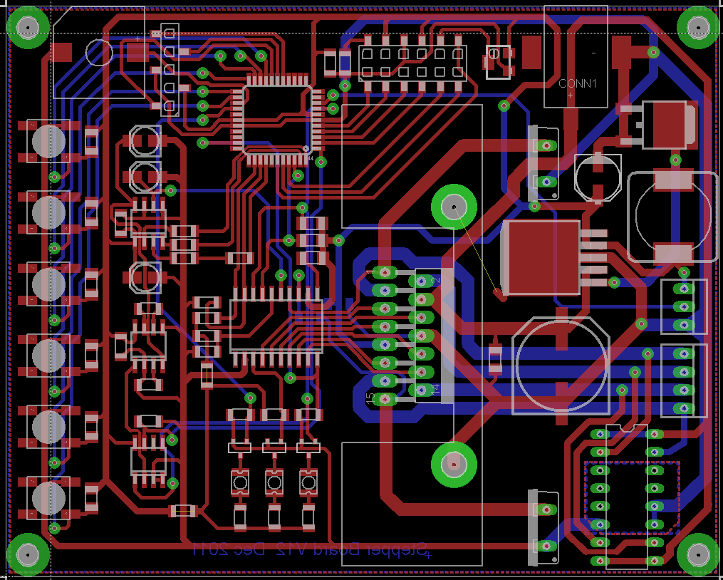

Is it really neccessary to use Imperial? Datasheets for many of the most recent components have metric units as their primary dimension units, certaintly for some of the passives for which I've been making library components. If I design all my own library components (tedious sometimes though it is) using metric units and layout both the schematic and pcb on a metric grid, should that be a problem?
I know what you mean about off-grid and angle errors as I'm getting a lot of these on my current pcb because I've used both metric and imperial. It's a bit of a mess in that regard but as it's a home made pcb I'm not too worried so long as it looks neat.

most boards containing SMD components still contain inch-based ones like caps, tactile switches and connectors.
SMD parts are manufactured in a metric scale, but there also some amongst them with a pin distance of 0.35mm. Using a grid size of 0.3175 the grid is still inch based (25.4/80=0.3175) and will give you the necessary resolution. If that won't suffice use 0.15875mm or even 0.079375mm. I sometimes use a grid size of 0.0396875mm if circumstances require to do so.
Using that grid and draw traces out of the SMD pad the joint will be straight in.
I noticed on your board design that all (probably pushbuttons) have air wires within all four SMD-pads caused by grid mismatches which can be eliminated if you use the above described method for routing. (Don't forget to blank layer 19 ("unrouted") when printing the PCB layout.
You will see that when performing "ratsnest". The autorouter will point out all air wires without creating an error list.

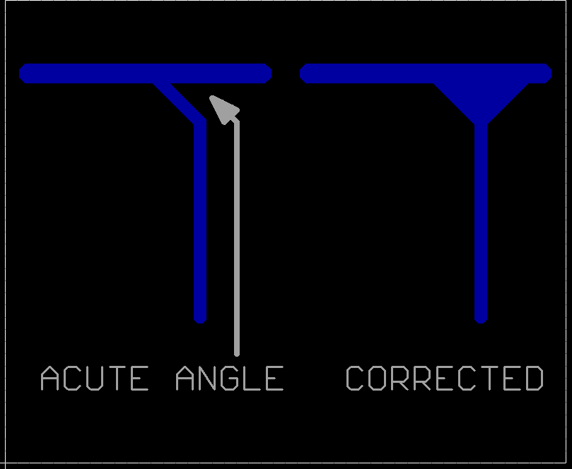

A neat PCB layout is neat if there are no acute angles in traces. Your design is full of those acute angles making etching more difficult. If traces join at a 90 degree angle draw two 45 degree angled off traces manually to meet on the trace they angle off. (Please refer to the attachment.)
I have done a lot of PCB designs with mixed through hole and SMD parts and using an inch based grid I had absolutely no problems. The autorouter will not work properly if you use a metric grid because it also uses inches or fractions thereof.
