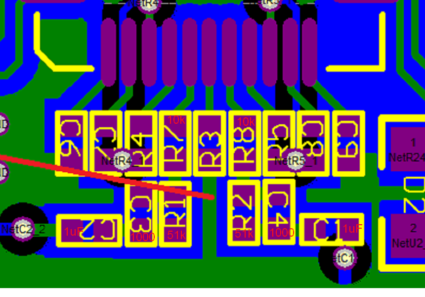

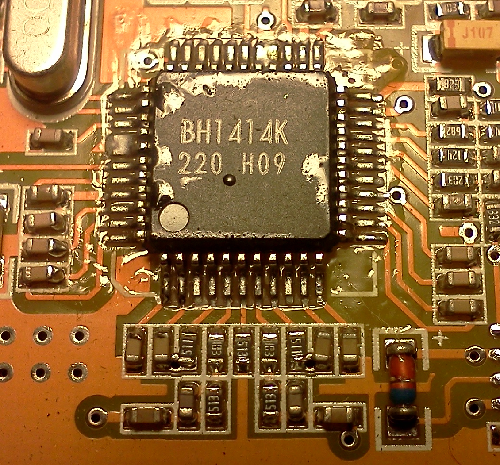

Below is a photo of the chip on my circuit board.
At the bottom left of the photo is the left channel circuit and to the right is the right channel circuit.
1-png.95528
Does anyone have any clue as to what has to be changed for the correct 75us pre-emphasis curve?

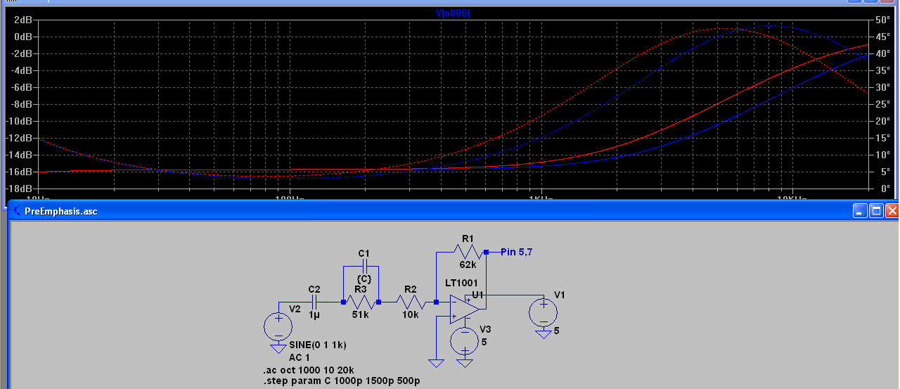

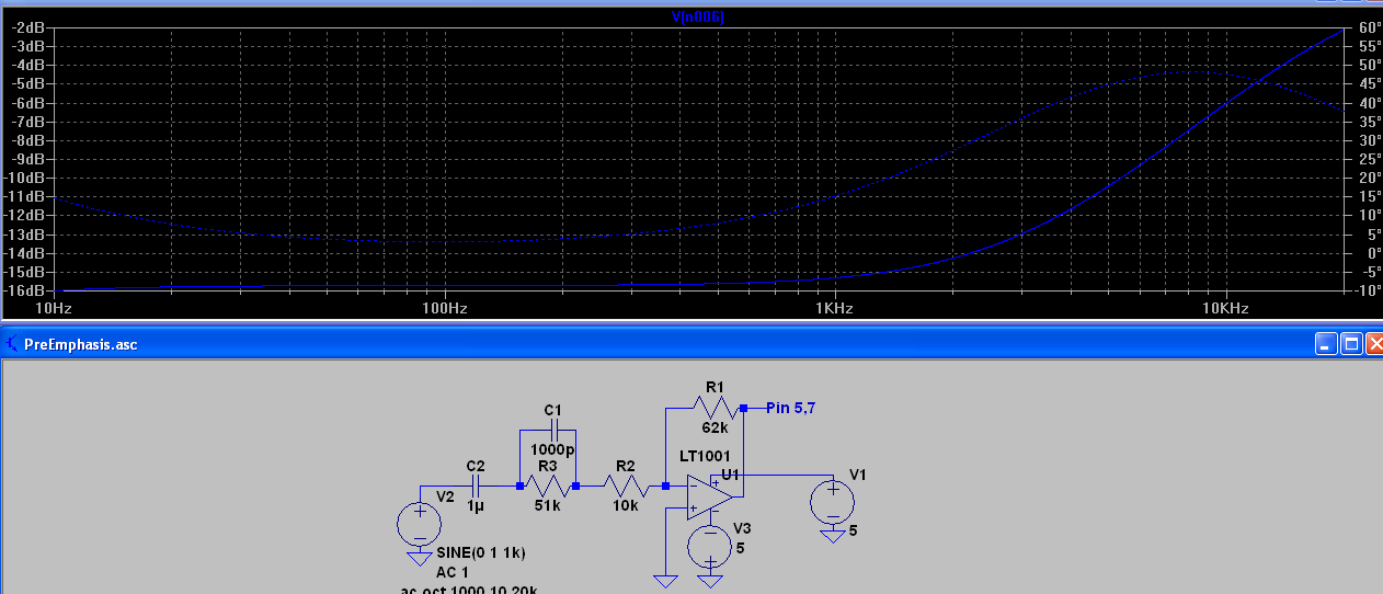

Here is the inputs (pin 5,7). The op-amp and R1 is inside the part. R2,3 and C1,2 are out side.
The graph is the gain in db from 10hz to 20khz.
The dotted line is phase shift.
Here are the two curves for 1000pF and 1500pF.
So you can add a 470pF on top of the 1000pF cap or replace the cap.

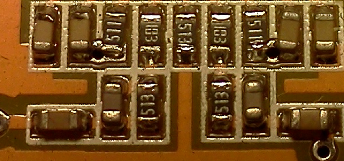

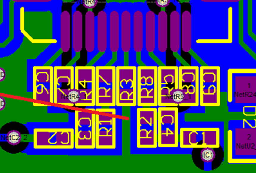

Okay I am uploading an image of the part numbers in a map, the one that the seller sent to me referring to the capacitors that needed to be changed, which are C3 and C4 need to be changed to 1500pF, the resistor values in that R/C circuit are 51k Ohm, there also appears to be a SMD capacitor just before the R/C circuit which is C1 and C2, I can not tell if that is a electrolytic capacitor or not, but it is in the blown up photo I am including below showing greater detail of the circuit board and the numbers printed on those resistors. ( For that please see image #2)
Hopefully these images will give greater detail a precise answer and in the end help anyone else who is researching this same issue.
Bruce.

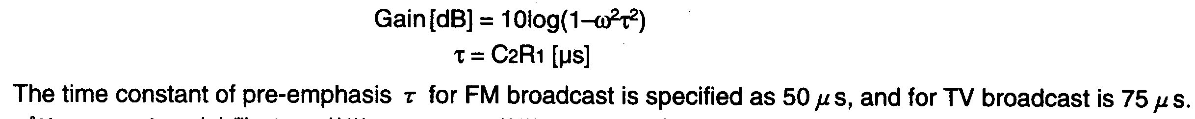

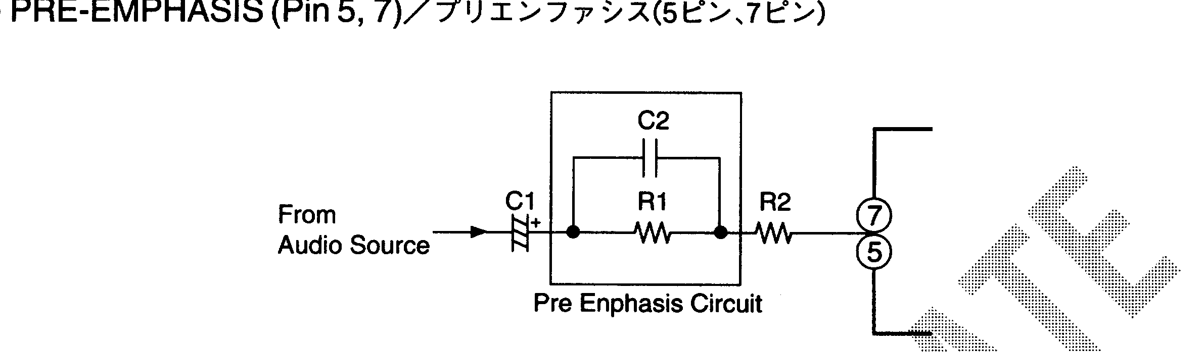

According to the ROHM data book on the BH1414K IC chip, it says:
Quote: for example, to set the pre-emphasis to 50us, make C2 = 1000pF, R1 = 51K Ohm and R2 = 10 K Ohm.
The numbers you used above in my map would result in 50us pre-emphasis, not 75us, which is what I am trying to set the pre-emphasis to.
Please see these images below that back up my point these images were photographed from the ROHM Co. manual for the BH1414K chip.
Read what it says above the graph.
Those values you gave me would result in 50 microsecond pre-emphasis if the ROHM data book is correct. I need 75 microseconds not 50 microseconds.
Or perhaps you were just providing what the current values are on my circuit board, then I can understand, that it is set to 50us and changing those 1000pF caps to 1500pF would in fact change it to 75us, is this correct?
Bruce.

Below is one formula for this chip from the data sheet.
R3 and R4 are supposed to be 51k ohms then C3 and C4 should be 1000pF for 50us and should be 1500pf for 75us.
The bass frequencies are absolutely flat from about 13Hz up to where the pre-emphasis boosts the levels and 2.6Hz is at -3dB since the input capacitors are 1uF and they feed 51K + 10k. So there is no bass boost.
Changing the pre-emphasis from 50us to 75us boosts high frequencies more and does not affect bass frequencies.
