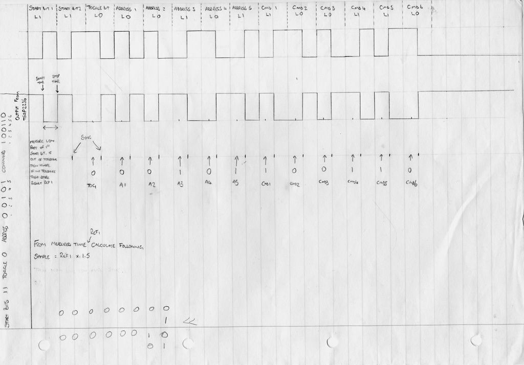

I would suggest you're probably going about RC5 the wrong way?
889uS duration of an RC5 communication pulse
The whole point of Manchester coding is that you don't need accurate timing (because you don't get it with IR or wireless), it's the transitions from high to low, and low to high, that are the data - not the time between them.
Yes I think you're right, accurate timing is not required. Infact there is quite a large margin for error with my program. I decided to measure the pulse so that I could account for errors between remote controls. I didn't check a sample of remotes to see what the error was likely to be though, I just decided to write the software such that almost any error could be accounted for.
It works though - I was quite chuffed to be honest!
Brian
Oh, the other reason I timed the pulse was so that I could calculate where to sample. The program synchronizes on the high-low low-high transistions and then takes a measurement which should be not far off smack-bang in the middle of the pulse.
Hang on... I think I just understood what you're saying. Hmmm I'm gonna go back to my timing diagram and see if that would work. If it does, I've done quite a bit of work for nothing, but I learnt a lot so it doesn't matter anyway :)
Brian
You cannot ignore time. If you ignore time wont you always receive 1010101010. Surely, receiving Manchester encoded data is exactly the same as RS232 (timing wise) except you get twice as many bits.
Here's a copy of the timing diagram I drew when thinking about how to write my program. The data is just a random address and command that I picked off the top of my head.
Brian
