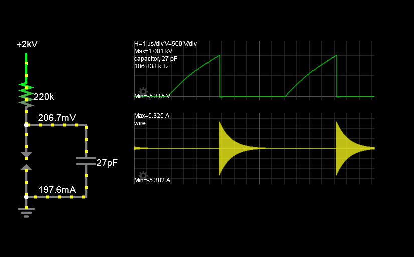

So I visited this page, with a spark gap oscillator on it.
I stuffed around a bit with it, but unless the resistor on the "base", if u could call it that, is at least a megaohm, it didn't seem to oscillate, but I could be wrong, how come?
And the model for the spark gap has a resistance? Why is this? I didn't think spark gaps would have resistance.
Is this simulation an accurate one?

Air has a natural breakdown voltage. When the potential is high enough, an ion trail is created that allows current to flow. That current will flow as long as the potential can maintain the ion trail. This is the same process as atmospheric lightning. There are things you can do in the construction of the spark gap that will increase the probability of generating a spark.
The simulator is perfect. We just have to calibrate your understanding.
Ohm's Law says the arc current will be 2kV/ 2M = 1mA
The gap component "properties" are: Holding current: 1m
Therefore, the arc does not release until the current falls below 1mA with R>= 2M.
DIACs, SCRs & TRIACs work the same way with a holding current to shut off.

Now a brain tease for the experts. Figure out why this spark gap oscillates with a damped sine without any inductance.
Ive got no idea, all I can say is its probably useful having a retriggered lc oscillator at super high frequency, that would go into terrahertz, one possible way to do it.
... it has to do with Nyquist theory and convergence errors when the exponential rise time approaches sample step time, and this appears as ringing. The arc conduction risetime is very fast with negative resistance gas tubes or spark plugs. In LC circuits ringing occurs when the current is switched off. INCars they use ~ 50 kohm carbon wire to limit the conduction current.
