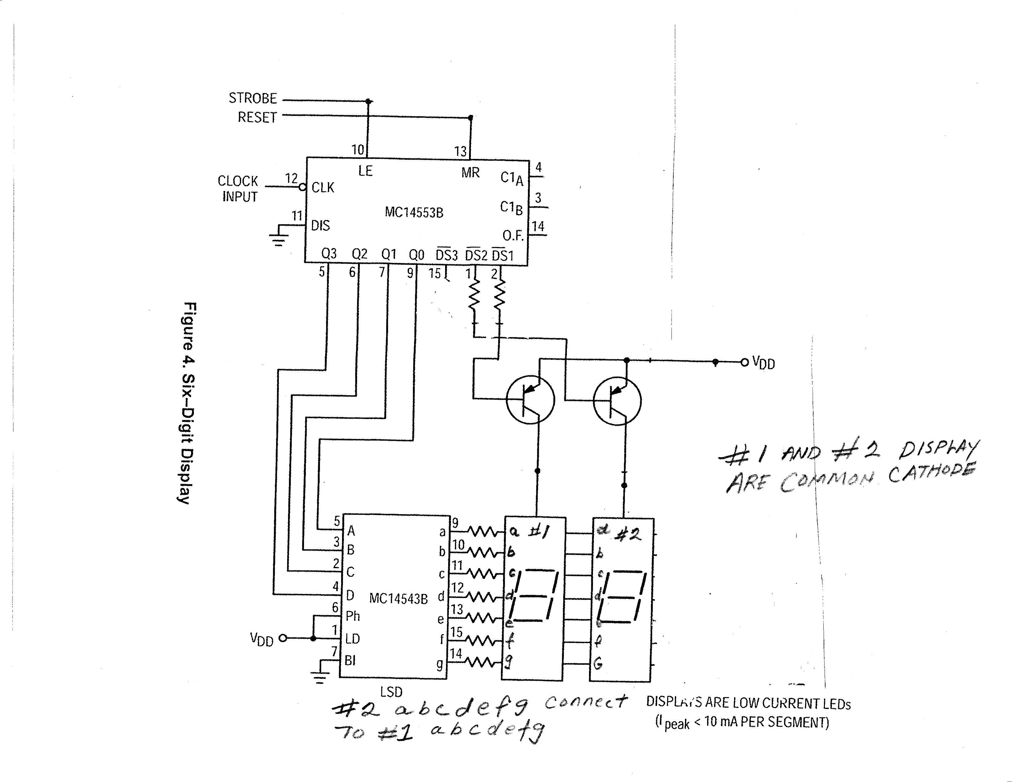

I have attached a schematic that we were relating to earlier that I found on the website for the MC 14553B data sheet. I hope that it is good enough for you to be able to view it. According to the data sheet for the MC 4553B the output current pin will handle 20ma. The 5 leds that I am using for each of the a, b, c, etc. segments, are in series using a 125 ohm resister rate at about 17 ma. per segment @ 12 volts VDD. The outputs from the DS1 & DS2 go through a resistor to a transistor base. The collector goes to the common cathode and the emitter goes to VDD. What resistance would you use @ DS1 & DS2 and what would you suggest to use for the transistors. Thanks again, I really appreciate your help.

I think the circuit uses common anode displays. The 4543 which drives the segements will only supply 10mA per segment, so you need to either increase the value of the resistor inseries with each segment or use an additional driver for the added current. The transistors for the DS1 and DS2 can be a pnp such as a 2N2907. I would use a 10K ohm resistor from the base to the DS pin of the 4553.

Thanks K7elp60, as usual you have been a big help. More questions though. It seems as though I have 2 choices now. I can either up the resistance to around 350 ohms to keep the output to 10 ma's to the display or use the ULN2004A driver chip. Since I would like to have the led display as bright as possible I am leaning towards the later. I assume that the ULN2004A connects the 1,2,3,4 etc. input pins to the a,b,c, etc.output pins on the MC14543B and the output pins of the ULN2004A go to the display. If my assumption is correct does it matter which side of the ULM2004A the resistors go on? Please feel free to correct me if my assumption is wrong. Thanks,
The inputs to the ULN2004 go directly to the output segments of the 4543. The resistors go between the ULN2004 and the Display segments. Make sure the PH pin(6) of the 4543 is logic 1. This makes sure the outputs are high to drive the ULN2004 properly.

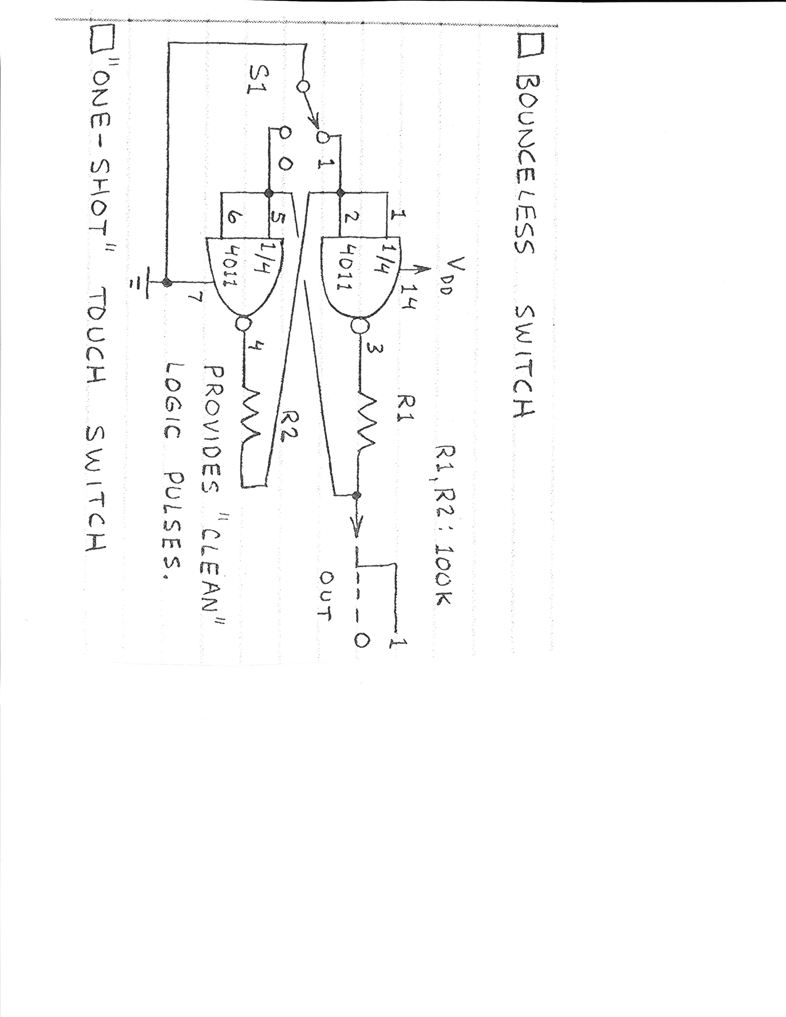

Ok, now that I have the controller and driver latch circuits fixed in my mind thanks to your help, I would like to know if I am on the right track regarding the manual pulse generator. I have attached a bounceless switch for generating the pulse that I would like you to have a look at. If I use a spdt momentary normally off switch for s1 would this circuit do the job. The outlet pulse would go to the clk pin on the 14553. Looking forward to hearing from you again. Sorry for being such a pain in the butt with all my questions and I do appreciate your patience with me. Take Care

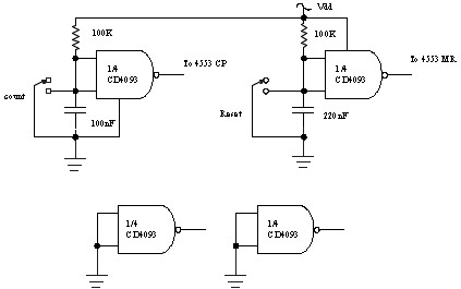

This circuit will probably work better. Both sections of the 4093 use momentary no switches. On power up the one that feeds the master reset has a longer time constant so the counter is reset to 0. The part of the 4093 that feeds the clock input to the 4553 also generates a clock pluse, but it's time constant is shorter so the pulse is ignored by the reset pulse of the reset generator. Pushing the reset button will also reset the counter when ever you want to.

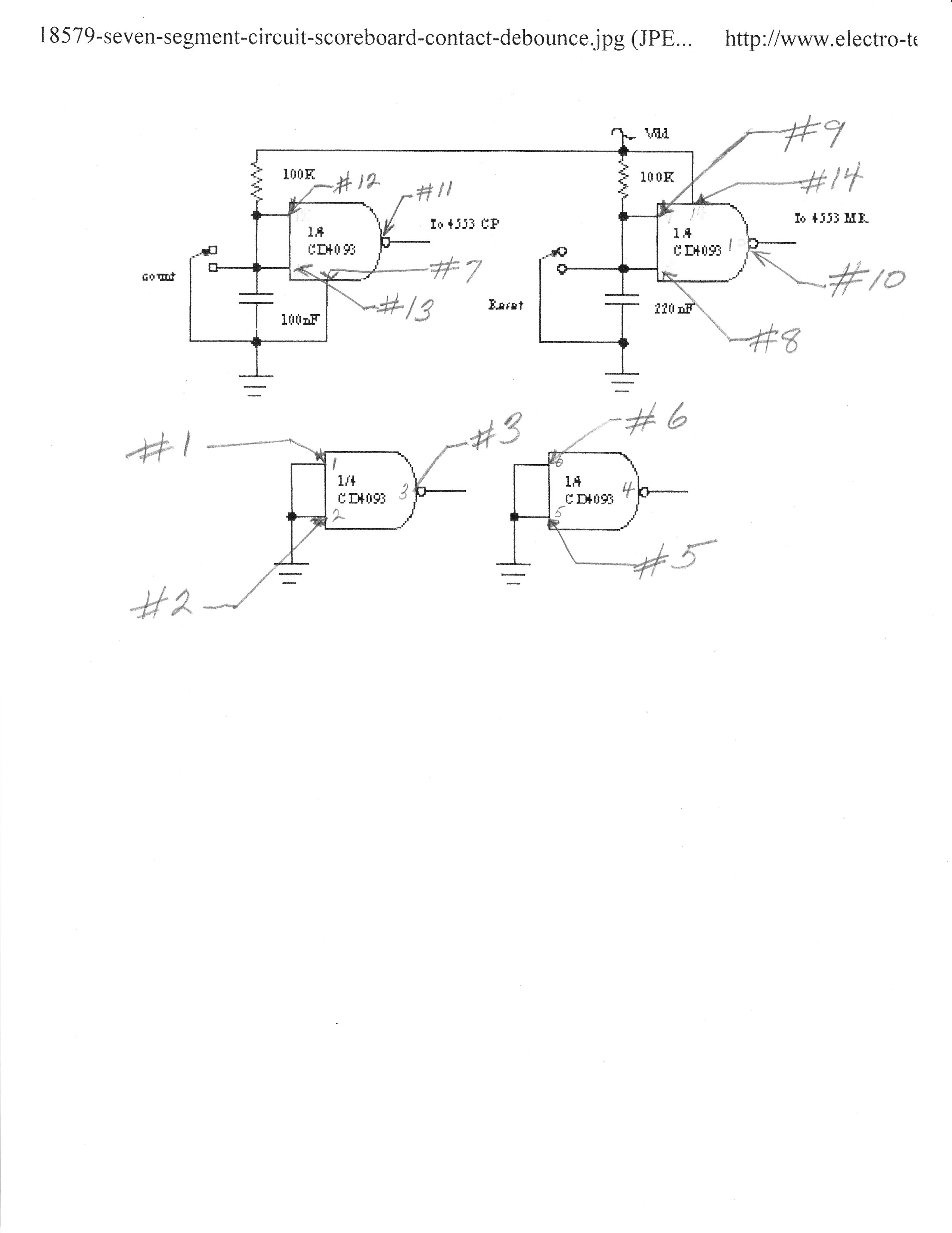

Good stuff k7elp60; Would you mind giving me confirmation as to the pin #'s from the 4093 chip. I think that I have it right. I have attached a marked up version of the schematic that you sent to me for you to have a look at. Could you also tell me what the 1/4 inside the symbol means? Thanks again.

You have the pin connection correct for the 4093. Sorry about the confusion with the 1/4 marking. It just means each nand gate is 1/4 of the total package of the 4093.
