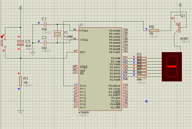

I did seven segment interfacing o simulation and on developing kit of 8051 and i was successful( when i did connect the seven segment only to the MCU in Proteus )
but now when i did implement it on my own general purpose PCB board with the circuit that is required for the hardware then i am getting error in output..
with the same circuit proteus also giving error on output
the circuit i am following is in the attached images
my code is as follows

You may want to swap the transistor for a PNP type...
no effect after using PNP type
can u tell me the appropriate circuit for this application.. with all the component that are required for this

You are trying to drive the transistor with a 10K resister... Well... 5v / 10000 = 0.5uA... It might not be seen... If you replace the resistor for a 470 ohm you will see something on ISIS.... You are also inverting the output so if you replace the transistor with a PNP and drive the base LOW!!! then it will work....
I have checked you code and it works fine if P1.0 is held low...

Your code implies that P1.0 is high.... If you want to drive the common anode you cannot use a NPN it must be a PNP,,, If you want to see anything you need to reduce the resistance value of the base resistor....
I have tried this and it does work.....

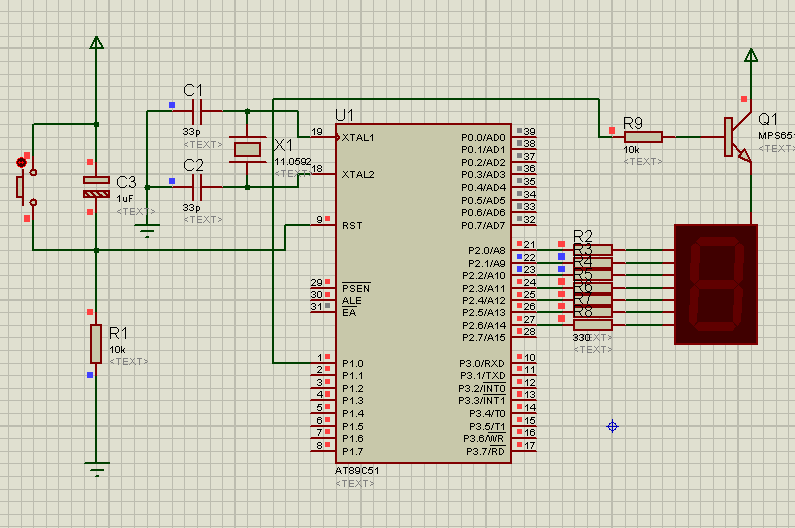

thanks to make me correct sir,
i did followed you by replacing PNP in place of NPN
now my circuit looks like this( in the attached pic)...
and i did make P1.0 low in the software code..
u can see it in picture
if this is correct.. why still iam getting a single segment on at all time...

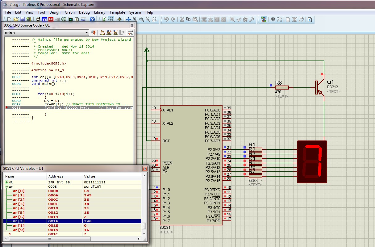

I did sir!!!
Here's a snap shot of everything running in ISIS.... Notice the i variable at the bottom and the value in ar[7]..
Thanks for help
