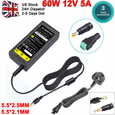

A 5.5 / 2.1 mm or 5.5 / 2.5mm roca style connector such as those is pretty much standard on DC supplies around 12V - 15V.
You could stick to those as a standard then you could also use off-the-shelf PSUs, as they are often cheaper than buying parts. They are what I normally use on prototypes, one offs and test gear etc.
12V "CCTV" power units are very common.
eg.
