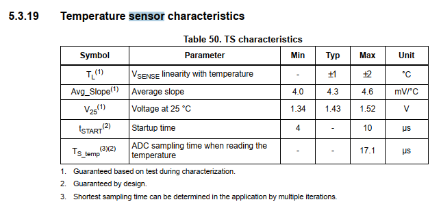

The CPU has an onchip T sensor -

This temperature sensor is, of course, measuring the MCU's core temp and intended as a check to keep the core in a safe operating range. Your mileage may vary when using it as an environmental temperature sensor as it has a slow time-constant and, obviously, heavily influenced by processing load.

Yes typically if one is driving costs one can consider halting processes, and due to
thermal mass use classic rate of change to get a final value T with a lot less delay.
Not sure how below (DS18B20) compares to using onchip sensor, would have to be looked at :
And being a shoe heater, relative to latency, how critical is that as issue, for either approach.....
