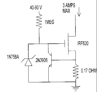

I have a 40-90V DC input driving some logic circuit.I am trying to protect the circuit by turning it off above 3 amps.I have checked some polyswitch fuses(have not found anything matching my requirement).I am also looking to implement it using a current sensor.I do not know how to proceed beyond this point , can anyone pls help.

The logic circuit has some mosfets driving a relay with pwm output.
The load current is 2.5 Amps ( maximum of 3 amps)
Any current limiter will do cutting off at 3 amps.There are no other low voltages.It is a little urgent Pls help.
Try putting this circuit in the return line. The IRF630 will get real hot when it current limits.
