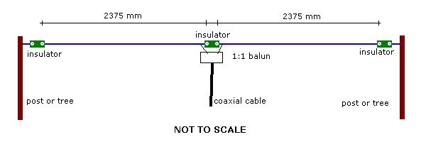

SW antenna
This should give you an idea of what papabravo is saying

Thanks for the fine picture!
2375 mm is pretty far away from 23.4 FEET. I'm sure the hams and SWLs in countries that use the metric system have an equivalent formula, I just don't know the constant off the top of my head.
Your antenna would be resonant at about 31.57 Mhz or 9.5 Meters. I'm not sure if there is a VOA station there though.

SW antenna
I am sorry, I was not clear....... I was trying to show what it would look like if you put up a dipole....... I forgot that I had mesurements on the drewing...
It is for a radio telescope, but it shows the basic idea...... Having said that, you could use any reasonable size for you antenna and add an ATU (antenna tuning unit) to it...................
Oh dear, I think I just made it more complicated............
