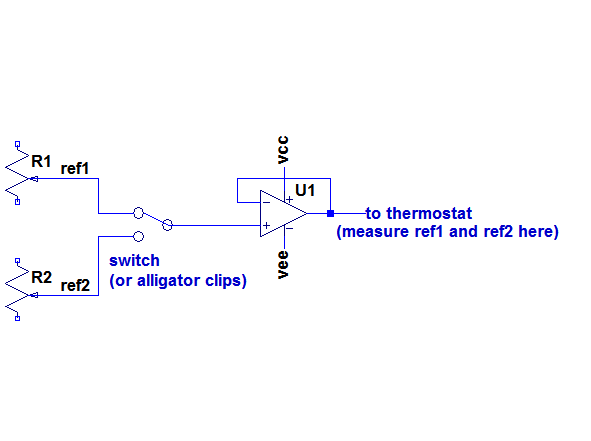

What has been suggested, and would be ideal is to build a signal generator with a 1V p-p amplitude that I can offset. Basically I need to go from 2.532V to 3.532V pretty accurately. Once I have this I can calibrate my thermostat circuit to output 0 - 5V.

Do you have an accurate voltmeter? If not, you won't be able to calibrate your circuit.
I personally don't think the square wave generator/scope method will be accurate enough. You can't measure 5 volts accurately on a scope. I would just generate the two DC reference voltages and connect them one-at-a-time to your thermostat circuit. Measure the output with your voltmeter.

I was wondering about this Ron. I have only just bought a scope and was working out how to use it yesterday. Soon came to realise that they are not that accurate. So I ordered a new multimeter, one that measures 0 to 5 in mV. And I'll do exactly as you have recommended, make 2 reference voltage points and calibrate to them. I'll probably play with the other idea too, a good learning experience. Thanks.
You should buffer your references. see below.
