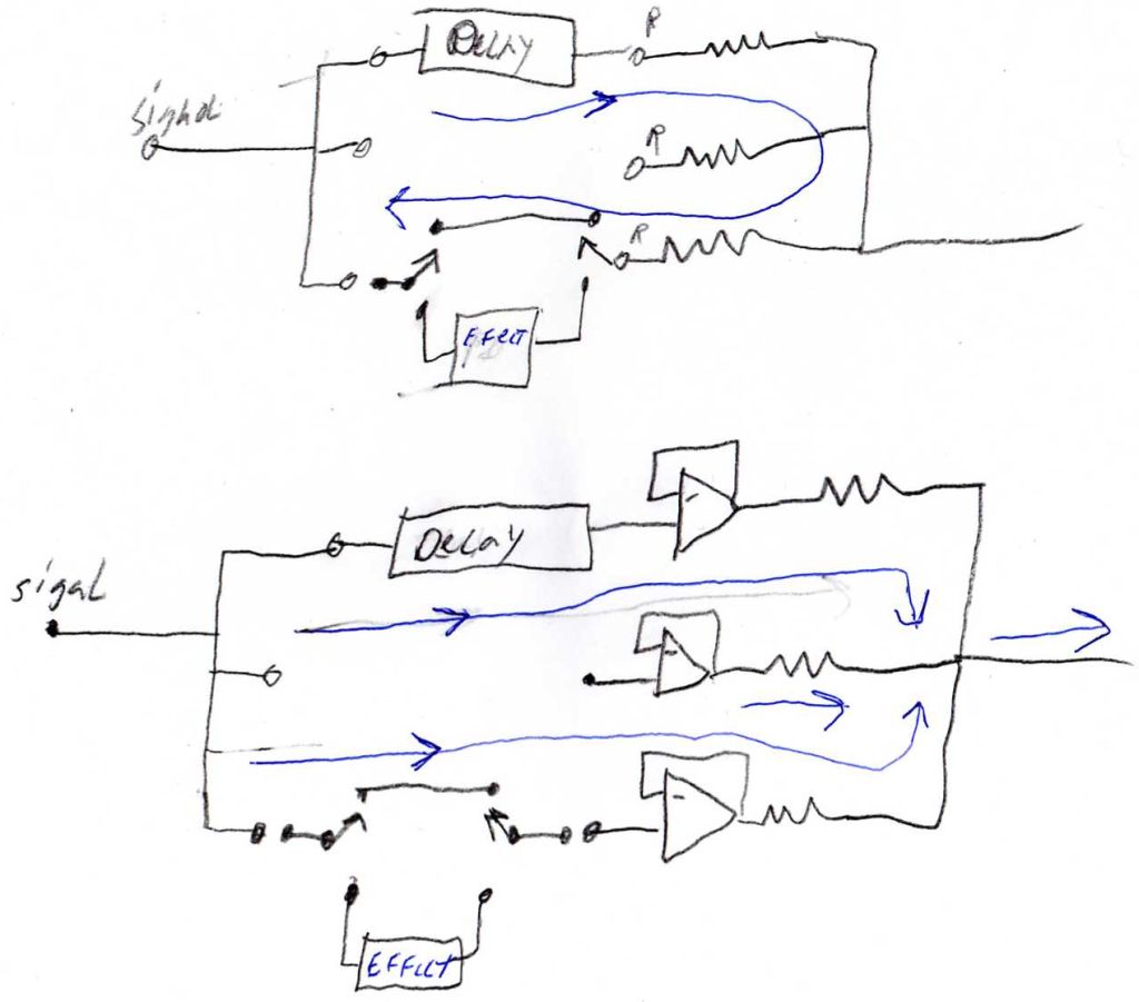

In the schematic it states pedal so I am assuming Stompboxes.
If you recall (from the 70's) that usaly DPDT (sometimes just a SPDT but improper) switch , Switches the effect in an out of the circuit and when it is switched out the input is directly connected to the output.
Since all of the inputs are tied together should one the Pedals be a delay unit for a slapback type of echo(For an example) it will continue to echo instead of being a single slap back and evenualy start to oscillate profusely if its gain is set high enough.
I am not trying to start any flaming war here I don't know how to explain it any simpler than that.
If you don't understand the bypass switch arrangement then I can put up an example if needed, But I am sure that you do understand its configuration and should not be necessary.
jer :)
Maybe this will help you to understand what I am trying to explain.
jer :)

i believe the usage of the term "virtual ground" to describe the inverting input of an op amp with negative feedback, while the noninverting input is grounded, predates the other usage of the term by several decades. I learned about it in the early 1960's, when op amps were made of discrete components (the first IC op amp, the uA702, was invented in 1964), and I don't remember seeing any applications that used a bias voltage to create the other type of virtual ground (to allow single supply operation) until many years later.
In your mixers, do you sum to an inverting input, or a noninverting input?
In most of my circuits I prefer to use the inverting input configuration,But it depends on what the circuit is for.
The gain calculations for the inverting is more straight foward as well.
Where gain=Rfeedback/Rinput ,vs, gain= 1+(Rfeedback/Rinput) for the non inverting configuration.
In most cases it can also eliminate the need for a resistor from the +input to ground thus reducing parts count.
The only time I use the non-inverting configuration is when it is imperative that the signal polarity must not be changed or if I need a high impedance input for a high gain buffer for things such as a guitar or high impedance microphone or using the unity gain buffer configuration.
When driving a Balanced output the signal polarity becomes irrelevant as reversing two wires corrects the situation if needed.
