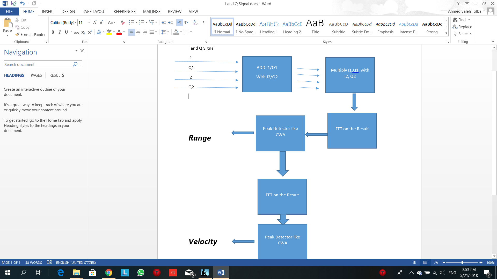

So I have read a lot of radar techniques and I'm going to use the mode FMCW, and the modulated signal will be a sawtooth (chirps).
I have 4 signals I1, Q1, I2, Q2.
I need to confirm my understanding of the signal processing algorithms
First steps.
![](https://i.stack.imgur.com/RN4AH.png)
According the answer, I wrote a basic algorithm, hope that's correct
First steps.
- I1, Q1, I2, Q2 to ADC
- Add I1 + I2, Q2 + Q2
- Multiply the result from 2 by conjguate of 2
- Apply FFT on the rows of the 2D signal I/Q to get the range
- Apply fft on the cols of the 2D signal I/Q to get the velocity
- Apply a third FFT but don't know on which block?
- Find peaks of each FFT block to get the Range, Velocity, Range.
