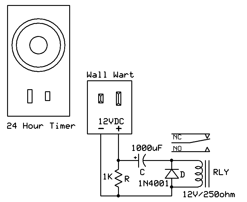

Long time lurker, third time poster. I have a question for you guys. I got a roomba and I hate having to tell it to go. I want to basically take a push button and convert it to automatically "press" once a day. I was thinking of soldering a 555 on to the traces as an astable vibrator with biasing to have it on for 1 second and have it off for a really really long time comparably(about 24 hours). Is there a more elegant way to implement this. It would have to be something simple because I will be soldering on to the traces.

A 555 is not capable of generating such a long delay period. About the longest you can do with a 555 is about 30min.
Here is a previous thread that deals with a 24h delay.
An easy way to do long, accurate time periods, with short on-times. Electro-mechanical wall plug timers have a minimum of 15 minutes on or off periods. Digital timers have a minimum 1 minute. Adding a DC wall wart with a simple relay-monostable will do the trick. And the output is isolated from the line and DC supply. The on-time depends on the size of the electrolytic capacitor, the coil resistance of the relay, and it's pull-in and dropout voltages.

Oops!. A reread of the post looks like you want it built into the Rumba. Do it with an 8-pin PIC or equivalent microcontroller.
