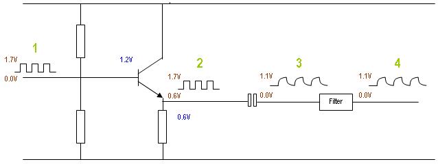

Ive attached a picture of what i think occurs with the pulse. Am i on the right track?
The voltage levels in stages 2-4 are approximations. In stage 4, can someone confirm that if the frequency of the pulse is correct, you will see a reasonable copy of the wave at stage 3 and the filter will have no impact? If on the other hand the frequency is not as expected, there will be no pulse at stage 4?
Thanks again.

Not sure what you mean by "the frequency ...is correct".
In general, we would not expect to see the waveshape as you have shown it at stage 3, since this is before the filter. The waveshape after the filter depends on what is in the filter and you have not described that. You imply that the filter is a low pass configuration made up of a resistor in series followed by a shunt capacitor. This implication comes from the shape of the waveform that you show at stage 4. The filter can be more elaborate than that, and if so, the waveshape at stage 4 would look a little bit different, perhaps a bit smoother.
However, in general, if the frequency is below the corner frequency of the low pass filter, then your waveshape at stage 4 is roughly correct, but at stage 3 it would look little changed from stage 2. If the frequency goes above the corner frequency of the filter, then the amplitude at stage 4 goes down, to zero eventually as the frequency goes much higher than the filter corner.
For a step input or fast risetime pulse the output risetime (0 to 63%) of a simple RC low-pass filter is simply (R × C) seconds. It's basically independent of the pulse frequency unless the pulse width and/or pulse spacing are less that about (4 x R x C) seconds. Below that, the filter will start attenuating the amplitude of the pulse as well.
