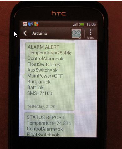

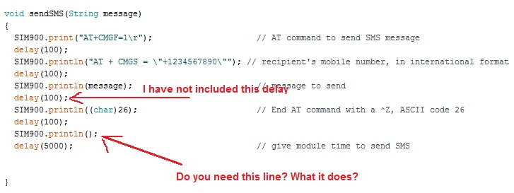

Some old code we used on a Sim900 module, should be very similar to the Sim800
  • Sim900.ino

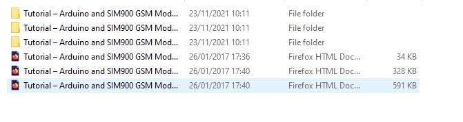

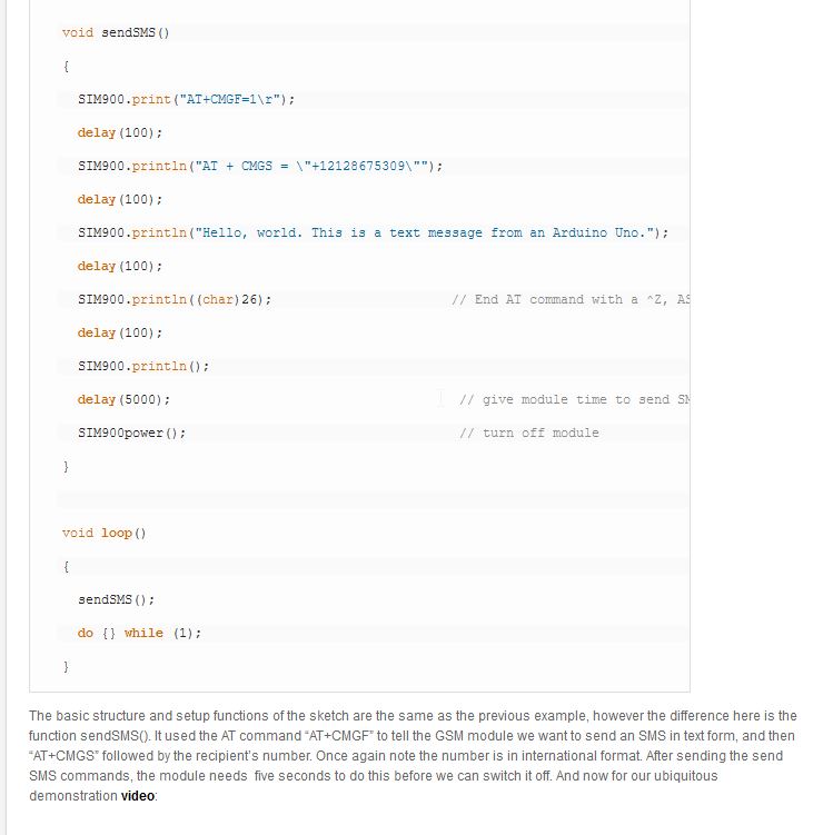

We used that code about seven years ago and cannot remember much about it now as we never used that project for long.
Cannot remember the source of the code we used either but as you can see each line is given a small delay so cannot see any problem with leaving it in there, it did work ok.
Ah, just found the original tutorial /code, does not seem to be on the web any more , but we did download it all at the time.
Seems we cannot attach those files direct or as a .zip file to this site.
If you do want them , you could PM us with an email address and we will send them over.
As you can see below those delays and serial prints were specified by the author, not us.
