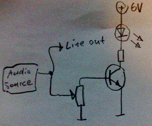

Hello, I'm very glad to finally find a good forum about electronics!
I would like to build a simple circuit, that lets 2 LEDs flash when there is an audio signal comming from a source. I'm speaking about a stereo line signal here, so 2 channels and 1 LED per channel only (1 for left, 1 for right). The LEDs should then flash after the audio signal reaches a certain amplitude and this point should be adjustable with a potentiometer.
So very simple actually. I was thinking about realising this with an opamp comparator circuit first, but maybe even a transistor is enough to do this proper!? As I'm not an engineer, I would like to hear some opinions, hints here, from people with more experience than me.

Audio is AC. A comparator senses DC. You need to rectify and smooth the resulting DC from the signal to feed a comparator.
Maybe it's not necessary to use an opamp.
To keep it simple, I made a small schematics with a transistor.
Wouldn't that work?

OK, too simple maybe.
I just recognized that there of course should be something between the potentiometer and the line out, so that there is no influence on the audio.
Use a coupling electrolytic capacitor between speaker out and the pot. (100 to 220µF) should do.

Your POT is backwards. How much audio level are we talking here? Speaker level, line level, etc? What is the minimum level you need to trigger the LED? The Max?
If you reverse the POT as I stated, then your circuit will flash the LED on voice/music peaks. It will load the audio circuit slightly and could introduce distortion due to non-symmetrical loading. What is the ultimate goal of this project?
Yes I got that, the potentiometer is connected the wrong way sorry.
So how can I prevent that the circuit loads the audio?
I actually already mentioned everything in my first post.
The aim of this project is that the LED lights up synchron with the music.
So the music will influence the LED, but the circuit should have no influence at all to the music.
