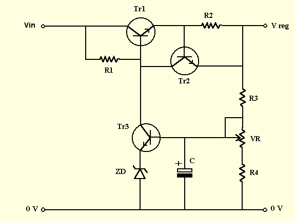

This article describes a simple 3-transistor voltage regulator with current limiting. It is based on a conventional design of unknown origin. The component values quoted below were chosen to provide a stabilised 12V 40mA output from a 17V DC supply; but I show how they can be calculated for a customised output.
The circuit

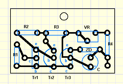

A suggested layout is:-
How it works

I want to layout the circuit>>but could you specify the zener diode model number..and also the transistor 2 and 3 models?/
Examples are:
Zener BZX79-C5V6 or 1N5339BG,
Transistors BC184L, BC327 or 2N3704
Doesn't C degrade the transient response? Won't it have poor load and line regulation? If the zener was in line with the base instead of the emitter, its current wouldn't change quite as much due to change of input voltage
Probably, but it was intended to make for smoother adjustment of the output voltage with the pot. Remove it if not needed.
It's ok, not brilliant; but for better reg you'd need a more complex circuit if using discrete components rather than an IC.
Not sure about that. For circuit simplicity some zener current change is inevitable wherever the zener is placed. If the zener were in line with the base then the current through it would be very small and its knee voltage would be less well defined (leading to poor regulation, hence current change) than with the zener in the emitter line. So its swings and roundabouts.
