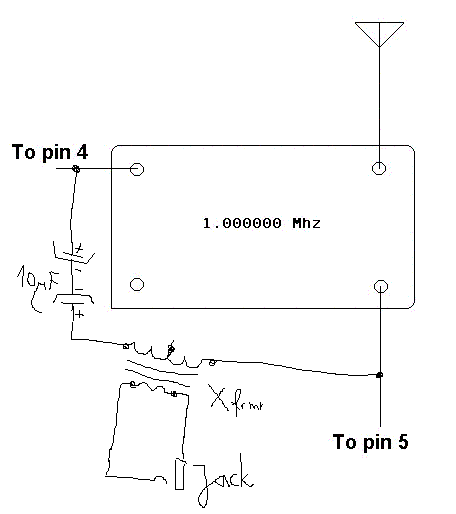

Well, I guess it doesn't HAVE to be fixed. I wanted it to be because I'm building it for this: **broken link removed** and I wanted to be able to fit a tranceiver (the circuit show on the page and the circuit I'm requesting now) inside of a very very small box that could hang off the end of a 3" (or so) long cord coming from the DB9 hood. And I wanted to make it as simple, small, and adjustment free as I could. If you read the page you'll see that the crystal sends out 1Mhz signals. That's why it needs to be a 1Mhz radio. I just thought the fixed version would be cheaper, smaller, easier, and that it would take less current. BTW, do you think I can draw enough power from the serial port along with the power being drawn by the crystal to power the radio as well? Thanks a lot. :)
Rain
Just as I tought... :D
Well in that case you don't need AM radio at all, just hookup the
headphones to COM port. I would recommend adding transformer
from output stage of old transistor radios since all headphones
I've seen lately are low impedance (like for your walkman).
You might have to add capacitors in series with the primary of the transformer (like 10uF, 25V).
These transformers are really tiny https://kitsrus.com/jpg/at.jpg
and would probably be best fit for the project using as few parts as possible.

I'm afraid I don't follow. How is this going to receive the signal from the other computer? I'm going to have two computers, each with a transmitter and a receiver. That way, I can send messages from one computer to the other and back. They are about 50ft apart. They are both going to be the same, therefore they will both put out 1Mhz signals. So I know they are also going to pick eachother up as well, :lol: but that's not a problem.
Electric Rain said:
I'm afraid I don't follow. :? How is this going to receive the signal from the other computer? I'm going to have two computers, each with a transmitter and a receiver. That way, I can send messages from one computer to the other and back. They are about 50ft apart. They are both going to be the same, therefore they will both put out 1Mhz signals. So I know they are also going to pick eachother up as well, :lol: but that's not a problem.
Maybe not just as I tought...
I had impression you wanted to simply learn morse code and monitor
what is being sent - on the computer you use as trainer...
Yeah, looking at your schematic, it looks like that's what you thought. So what now? :? Thanks for your help everyone.
