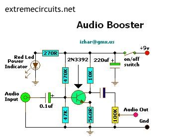

This is a circuit diagram which i want to use it as a project. Can you please tell me that which type of audio input & output would it be applicable for this circuit like (how much watts).
Kindly please help me to perform manual calculations for this circuit.

It's a small signal audio pre-amplifier with a gain of just under 18.
It's used for connecting a microphone to an audio amplifier.
The input power is a couple of nW and the output power is a few hundred nW which is still to low to drive an earphone, let alone a speaker.

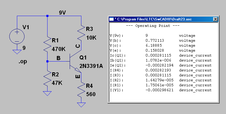

Compare your calculations to this
