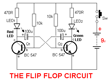

A Google search of "transistor flip-flop" turned up this circuit, which uses two transistors and a handful of other components. The text describes it's operation in pretty good detail. If you just want one LED, you should be able to just leave one of them out of the circuit, but don't remove it's resistor.
Here's the link for the page it came from:**broken link removed**
**edit** After looking at this circuit more closely, its actually a free-running oscillator which will "flip-flop" the LEDS back and forth as long as the pushbutton switch is held down. It could be modified to do what you want though. Sorry bout that! :oops:
Yes, it's an 'astable multivibrator', to latch you need a 'bistable multivibrator'.

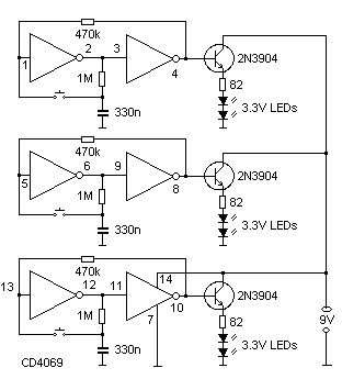

This does exactly what you want, I have used it on a few occasions. May be more complicated than you thought and it does use current when idle. Adapting it for your needs is pretty straightforward but ask for help if you need.

Dr. EM, thanks for the schematic. For my application, I guess I would need only one of the three units shown. Also, I need to switch a DC load of up to 75W @ 12VDC, therefore I'll need to put a MOSFET in there to do that. I guess I could just replace the bjt with an N-channel power device? Or would I need additional current boosting before the MOSFET? Thanks.
The CD4069 can drive a power Mosfet perfectly with a 12V supply, with the source of the Mosfet grounded and the load is between its drain and the 12V supply.

Doctor, I'm not seeing how it draws current when idle (if the LEDs are off).
With any supply voltage within their ratings, if the outputs of all 6 inverters are high or low without a load, the supply current of a CD4069 is typically only 10 nano-amps. That is one-hundredth of one uA. If it didn't self-discharge, a little 9V battery could power one for more than 10,000 years.
