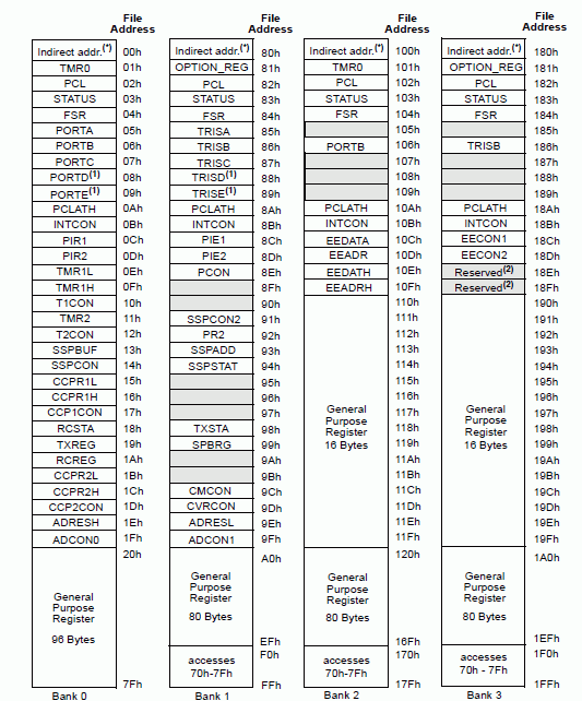

I started working with indirect addressing as suggested by dougy83. Everything appears to work except when I write info into memory address 170h. When I write to this address it also writes to 70h, f0, and 1f0. What am I doing wrong?
Dan
You're not doing anything wrong. The top 16 bytes of each bank are shared between all banks (see picture from datasheet). If this is a problem for you, you will have to incorporate bank switching to access your 100-byte buffer (or just use 96 bytes in your buffer).

If you use the area at location 0x120 to 0x16f and 0x1a0 to 0x1b3 you can do the following,
	bsf	STATUS,IRP	;use banks 2 and 3
	movwf	INDF		;store value
	incf	FSR,f		;inc pointer
	movlw	0x70		;reached 0x170 yet
	xorwf	FSR,w		;set Z flag if reached
	movlw	0xa0		;preload W
	btfsc	STATUS,Z	;test result of xor
	movwf	FSR		;reached 0x170 so skip to 0x1a0
	movlw	0xa0+0x14	;reach 100th byte
	xorwf	FSR,w
	movlw	0x20		;as above
	btfsc	STATUS,Z
	movwf	FSR		;wrap back to 0x120
