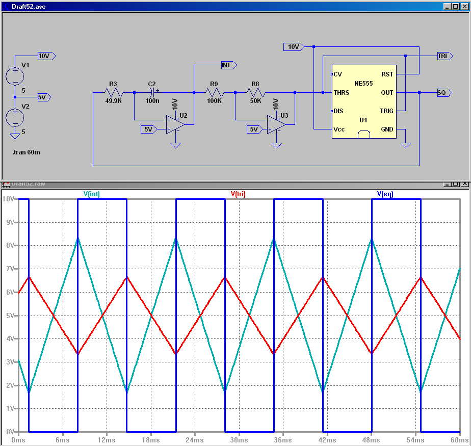

Your triangle generator drawn and simultated using LTSpice:
