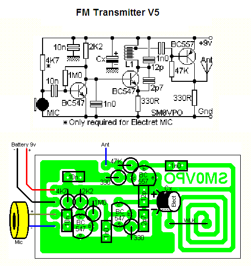

fm transmitter
is there any way to amplify the output from my fm transmitterbecause it only transmitts obout 50 meters. i,ve tried increasing input power but it just cuts out. i,ve tried adding a bigger antanna
but i didn't notice a difference. do you know any way to amplify the signal without the use of any complicated stuff like ic's
Adding a simple RF amplifier can boost the range and increase the frequency stability of an FM oscillator.
Some FM transmitters use a transistor RF amplifier with a resistor as its load. My FM transmitter uses a tuned circuit.
Here is one with a transistor RF amplifier using a PNP transistor. An NPN transistor could be used instead.

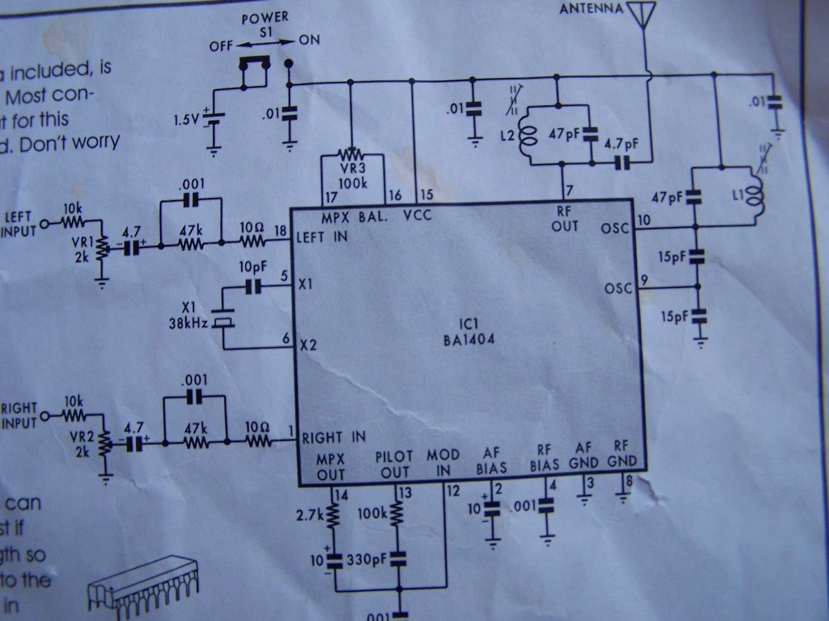

fm transmitter
is there any way to amplify it with some transistors and easily avaliable components. so i can build it myself i'm not that good at electronics. i've also got a picture if that will help
fm transmitter
i also have some diagrams to help.

Hi Things,
How is the performance of your old BA1404 stereo FM transmitter kit?
Rohm made the old BA1404 IC (it is obsolete) and has replaced it with the much better BH1417 that is used in the Micromitter project.
The old BA1404 did not use a crystal for its RF oscillator so it drifted its frequency all over the place. Its stereo 19kHz and 38kHz uses a crystal but their harmonics cause interference with its RF oscillator.
These ICs are made to transmit a few meters from a MP3 player to a car radio. I don't know about an RF power amplifier for them because using one would cause interference with other radios and would be illegal.
fm transmitter
i don't intend transmitting very far but a bit more than it can now. Do you have any diagrams for a simple amplifier i can build. i wat to be able to link the amplifier to the antenna output. Is this possible?
