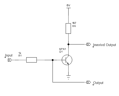

Hi all,
Very simple circuit that i would like you to have a look over.
I am trying to make a inverter with an enable for motor control. The transistor inverter switching times are fine, but i need to be able to put both outputs to the same state at the same time (i.e. a braking state).
with the current circuit i would have to put PWM at 50% to create an average voltage of 0V across the motor, but this is a stall rather than a break and uses too much current. any ideas?
Many thanks,
- Martyn

By using an inverter to feed the two inputs of the H-bridge, you have removed the capability of using it as a brake - in order to do so you will need seperate feeds to the two halves.

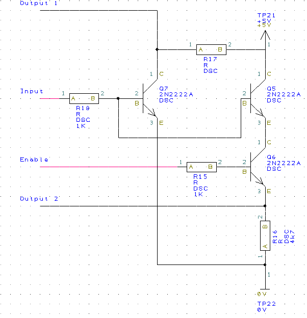

Ok, this should work.
I believe its a NAND gate on the second output?
By putting the input high and the enable low the outputs will both be the same, but with the enable high both signals will be different no matter what the input.
Sorry about gif size, resizing lost lines, not too sure with Easy PC AMT.
You cannot have three states using just one control line.
Three possible solutions:
1. If you do not need speed control of the motor, connect ENABLE to +5V permanently. Let the PIC controls input2. Use software to invert the state of input1 and outputs that on input2. If you want braking, set both imputs to same state. You can leave motor in braking mode as there is no additional current drain.
2. Leaves out inverter and use an extra pin on PIC for rotation direction control. But I guess you would not have to use an inverter if you got spare pin on PIC in the first place.
3. Use some form of external circuit logic to decode the three state of the input1 namely HIGH, LOW and PULSE and translate this into the "H,L", "L,H" and "H,H or L,L" for the L298.

Is exactly what i want, i will just use a little logic IC from TI or something ;)
A is enable and B is the PWM/IO input. I am controlling 2 motors using the pwm outputs from a pic, of which there are only 2. I can easily (a few lines of code) dissable the pwm and make the output any logic i need, which in this case is A low and B low to make a 'brake' state.[/code]

A simple way to do it is to feed the ENABLE pin from the PWM output, then use two I/O pins to feed the two H-Bridge inputs. So the ENABLE input sets the speed, and the two h-bridge inputs set either forwards, backwards, or brake.

In that case you will have to add a fair amount of extra hardware, and either use the enable line to operate a braking system (when it's disabled), or add an extra specific brake line from the PIC. I would also suggest that you design hardware logic into the design, the more complicated it gets the more likely you are to inadvertently apply the brake and full power at the same time.

As for external hardware, i will need 3 PIC lines for each motor, 1 with the PWM, one for the bridge enable and one to allow for 'idle' mode when both inputs to the driver are the same potential.
two of these: https://focus.ti.com/docs/prod/folders/print/sn74ahc1g00.html in a SOT-23 package and i am fine.
Much, much, much smaller than the 7404 i was using before.
