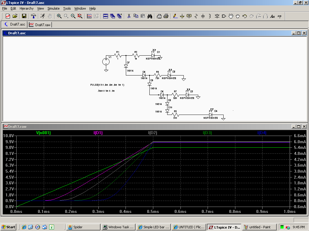

My intent is to build an led bar graph using nothing but 4 LEDs, 10k Pot, and some reisistors.
The aim is to light up more LEDs as the resistance on the POT goes up and less as it goes down.
Here is the diagram:
https://www.flickr.com/photos/41303266@N07/5139378745
The idea was that each junction delivers more than 3V needed to light up an LED when the pot is at 10k and less than 3 when the pot is at 5k
I didn't realize some mistakes until after I built the circuit. The problem is that one led lights (LED1 on the diagram) up only. After using a multimeter I found that there wasn't enough voltage across the others. Can someone give me some suggestions?

Can't be done. **broken link removed**

Don't know if you will like this one or not. More leds turn on as you reduce the size of the pot. They also gradually turn on as the pot goes from 10k down to 0.
