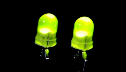

Ok guys, the ones I want to use are GW62S (the coloured photo not the three opaque ones shown in the search result)
The problem I see (and obviously I'm open to correction) is if I have four in series x four strings, then how do I change the colour of just one of the LEDs in one string?
The end result in a display showing which doors are open and which are closed. Total of about 20 doors. I want the green on when the door is closed and the red on when the door is open.

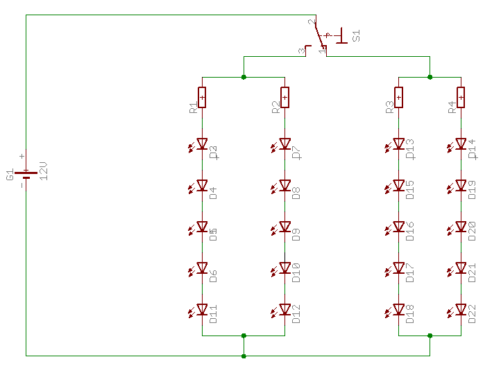

Now Styx mentions two in series. I'm going to need a few more than that (something like 20) so if each one needs 2.2v (maplins 3mm leds) then in theory I'd need a 44V power supply.... Is this right??????
well I mentioned 2 in series as a demo point (sine no other info given at the time).
So you need 20 and a rough guess state you will need 44V volts JUST to bias the LED's on (remeber you will need the volt drop of the burn-resistor as well)
The only other way then is to parallel the Diode's up. THis has a risk as each one might not share the current equally BUT it means that the voltage at the LED's would be 2.2V for 20 and not 44V
A compromise would be to do a series-parallel arrangement. Parallel to get the volt-drop down, series to increase the voltage so the burn resistor is lower

It will take a lot of fancy switching to put in series 3-wire bi-colour LEDs.
You need 2-wire LEDs to easily do what you want.
Or you could use a 3V power supply and a series 39 ohm current-limiting resistor for each bi-colour LED. Power both red and green when the doors are moving for yellow.

I don't think you want to put them in series if you want to change individual colors.
Can you clarify whether this is device has 2 leads, or 3? I didn't find the picture you were talking about. Perhaps you can post a link to the picture.

Here's the link for the LED

It's not impossible. However, you hopefully have learned here that you can never supply too much information. It seems like we have had to drag it out of you, but I realize that it is difficult for you to anticipate what we need to know.
So, another question: What sort of door open/closed sensors do you have, if any? Switches, maybe? If so, what kind of switches?

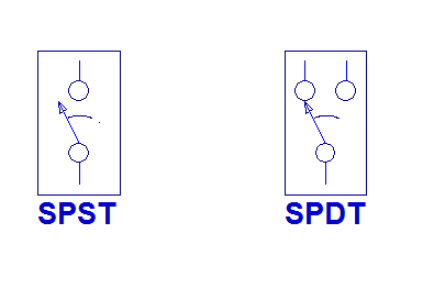

I gather from this that the doors currently don't have switches (or something) that will sense when they are open or closed, and you will have to add them. Is that true? We need to know if your switches will be SPST or SPDT. SPST (single-pole, single-throw) is either open or closed. SPDT (single-pole, double-throw) is closed to one or the other of the two "throws". Either can be made to work (I think), although SPDT is more versatile.

angie1199 said:
The problem I see (and obviously I'm open to correction) is if I have four in series x four strings, then how do I change the colour of just one of the LEDs in one string? This could be done, but you would need DPDT switches on each door
The end result in a display showing which doors are open and which are closed. Total of about 20 doors. I want the green on when the door is closed and the red on when the door is open. What type of switch do you intend to use on each door? SPST, SPDT, DPDT?Angie
If you answer these questions and the ones Ron H asked, then we can help you.
