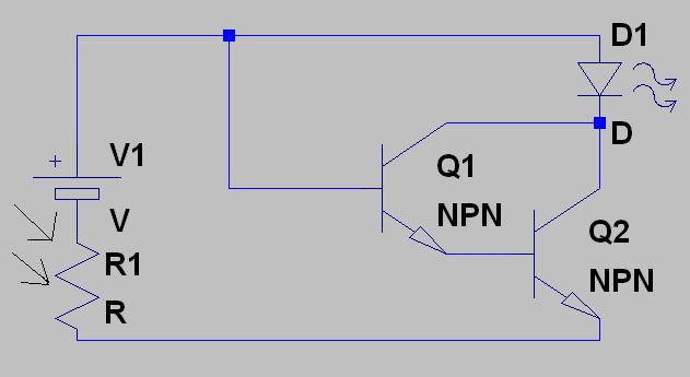

hi, i have done a circuit with a 9v battery, a buzzer, an LDR and 2 transistors, when there is no light i want the buzzer to sound, i am using a lazer on one wall and an LDR on another and when the beam is broken, i want the buzzer to sound can you see anything wrong with this circuit?
Thanks, Mike
oops sorry, the circuit shows an LED not a buzzer but i plan to use a buzzer

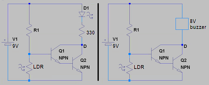

Here is how to turn-on a transistor or darlington-connected pair. Match R1 to the value of your LDR. The little 9V battery won't last very long if the LDR and R1 are low resistance or if the LED or buzzer are continuously activated.
should this be what resistance i want the buzzer to come on at?
The R1 determins the sensetivety of it.
If its low resiatance then the bzer will start even in dim light if its high then the buzer will need to be im a darker place to start.
done it, it works, Thanks :D
