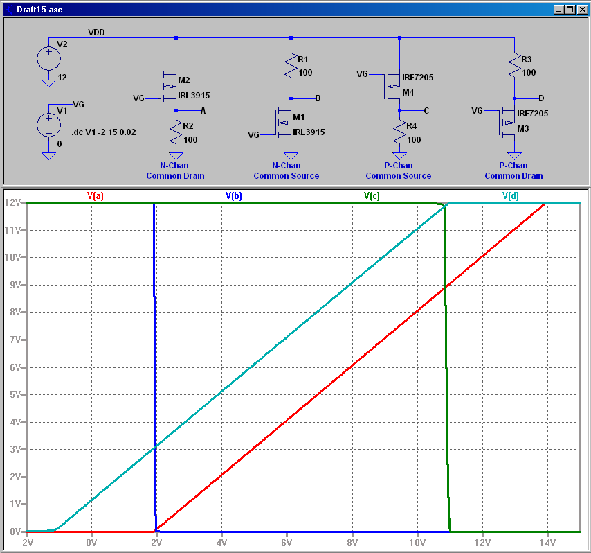

I'm trying to understand MOSFETs, but I don't understand what I am seeing with my simple test circuit.
I have a FDP8440 logic level N-Channel MOSFET. Drain connected to 12V. Source connected to an LED, a resistor, and GND in series. I am switching the Gate between 12V and Ground to turn the MOSFET on/off. Trying to KISS, I'm leaving out the pull-up or pull-down resistor for now.
Why does my meter measure 12V at the Drain, but 10V at the Source? MOSFETs are "current controlled" and I have zero resistance between the 12V and the Gate. Is there not enough current in the load (LED) for it to make it up to 12V? Or, is there some sort of voltage drop associated with MOSFETs (like BJT?).

You are using the MOSFET as a source follower. Vgs must be a couple of volts for the transistor to be ON. Connect the source to ground, and the LED/resistor to +12V. Then you will only get a few millivolts across the MOSFET.

Think of what happens when you put the load between source and ground, and the gate is at vcc. You probably know that most NMOS transistors are enhancement mode devices, which means they are off when Vgs=0. If the source voltage went to vcc (or very close), the device would be off. So - the source voltage will be less than the gate. The actual Vgs will depend on the load resistance. The lower the load resistance is, the higher Vgs will be, because higher Vgs is required for higher Ids.
Okay, I think I'm following you. The difference in voltage between the 12V and what I measured at Source is basically the voltage the FET required to turn on. Being a logic level FET, that's between 1V and 3V (according to the datasheet). Interesting that it even functioned...

Perhaps this will help explain what is going on: X-axis is VG as it ramps from -2 to 15V. Y-axis are the voltages at A,B,C, and D.
