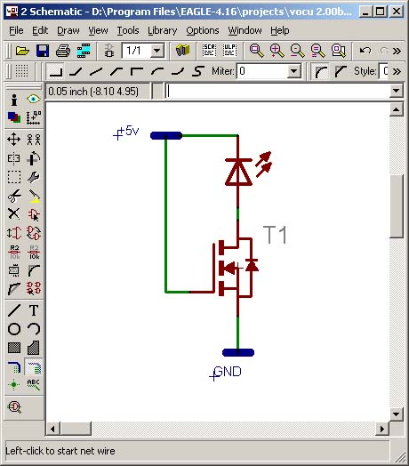

Quick diagram, hope I did this right :)

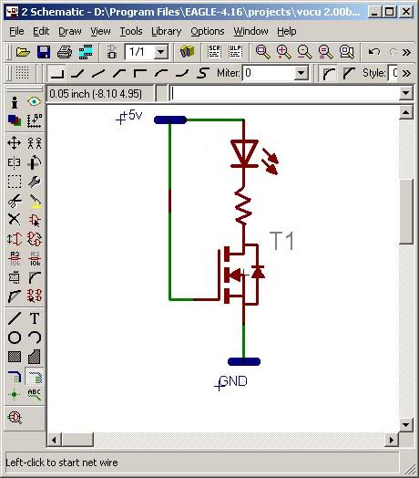

The output SHOULD be at zero volts when the gate is at +5V. This means the MOSFET is on. You have your LED symbol upside down, and you need a current limiting resistor.

Now you see why I'm confused :) I've tried 3 different FET models and multiple parts from each model and I see the same thing. My voltmeter may be cheap, but it will read 4.98 volts for my +5, and 4.5/4.19/3.79 on the drain, so I know there's a drop. I can also see it in the brightness of the LEDs.
I was thinking of a different circuit than the one I just illustrated. The one I was referring to of is one I have on PCB, not the test circuit. For the one I have on PCB I have the drain connected directly to +5v and the load is connected to the source. So when I turn on the gate I see +4.19/4.20 volts on the source but when I turn off the gate I get 0.00v. On the drain I have +4.98 or so volts. But whether the load is on the drain or source side I get the same voltage drop...
But the consensus is this relatively large voltage drop is not normal? If not, what "feature" of these FETs could be causing it and how can I select one that doesn't do this?

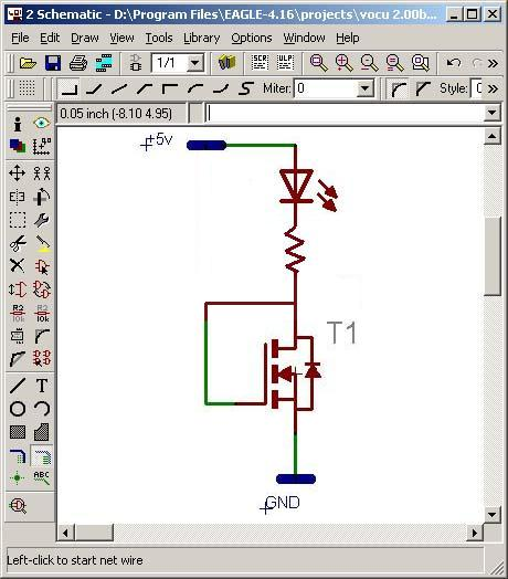

Are you sure you don't have it connected like this?
Yep, that's how I have it connected - my original diagram was off. It was a late night last night :)
So it's normal to drop voltage like that when connecting a load to the source side, but not the drain side? That'd odd - why does this happen?

For NMOSFETs, the gate must be 5 volts (or whatever the spec says) more positive than the source in order for the FET to be fully on. If you tie the gate to the drain (as in the schematic I last posted), the transistor will be off when the drain (and gate) are at zero volts (actually, any voltage below the threshold). In fact, this is negative feedback, and the drain voltage will be dependent on the individual transistor's threshold voltage, and on the load. Threshold voltage varies from one part number to another, and even varies considerably in those with the same part number.
