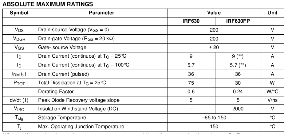

I have a problem reading the datasheet, so I would really appreciate some help.
For example: IRF630
The maximum rating for V(gs) (gate source voltage) is +- 20V
The mosfet will turn on when V(gs)th (gate treshold voltage) is 2/3/4 (min/typ/max)
How to interpret this?
What I assume is that if V(gs) is 0-1.999V the mosfet will be closed (ds resistance infinite in theory) and if V(gs) is between 2 and 4V the mosfet will open (ds resistance <0.5R).
But, the part that I do not get, if the maximum rating for V(gs) is +-20V I assume that if V(gs) is for example 10V, the mosfet will "open" and when V(gs) goes to for example -10V the mosfet will close.
I attached the parts of the datasheet that are confusing to me.
Another thing I would like to confirm (just to know I understand this correctly), mosfet is "open" or "closed", there are no "in between states" like with transistor, when I the potential difference between gate and source is > 2V it will open, and DS resistance is "same" for 2V and for 4V, right? it does not corellate as with transistor (ok transistor correlates base current but this is just analogy)?
thanks in advance

A mosfet dose have a "in between state". Its the same as on a BJT transistor, the harder you drive the gate the more it opens. But its not linear mostly it goes very slowly and then starts going up fast. That mosfet is probably a logic level mosfet because 5V would open it almost full. Typically 10 to 15V is used to drive MOSFETs and IGBTs because you always want to open it as much as you can so you get less heat on it. Also mosfet drivers can mostly supply about 1A of current, true that a mosfet takes no current on its gate, but the gate has capacitance and you want to get the gate from 0 to full in a very short time to again lower heating.
Thanks, so the DS resistance will vary on V(gs) ..
the min/avg/max and "apsolute max" still remains confusing .. what will happen if I get V(gs) to 15V? Will it "open fully" just like with 5V but start to heat or just open or ?
This one I showed up here is just example, I'm still deciding wich one I will try (will be driving them using micro controler so 0/5V or 0/3V) but in order to decide wich one to use, I have to be able to understand the datasheet.
Well 15V will open it even more than 5V and so make it heat even less. But at 5V its supposed to be almost fully open, so its resistance wont be as low as at 15V but it should be close to it.

"max" potential is not "open fully". If you look at the data sheet the Vgs(th) is for a drain-source current of 250µA. For more current you need a higher gate voltage. If you look at the Id((on) and rds(on) values, they are given at a Vgs of 10V. Thus for the lowest resistance "on" operation you should have at least 10V Vgs.

It might help to understand that Vgs(th) is the "threshold" voltage of the MOSFET, that is, the point at which it is just starting to turn on. Because of manufacturing tolerances this can vary from 2V to 4V for the IRF630.

A good piece of advice that make selecting MOSFET easier is to look at the Rds value on the datasheet, in particular what manufacturer have quoted for the Vgs condition to get this Rds value.
For IRF630, the Vgs quoted is 10V.
So one can usually assume the IRF630 MOSFET works with 10V Vgs normally. Any voltage values lower than 10V will make it "open less" and thus results in a higher Rds value.
