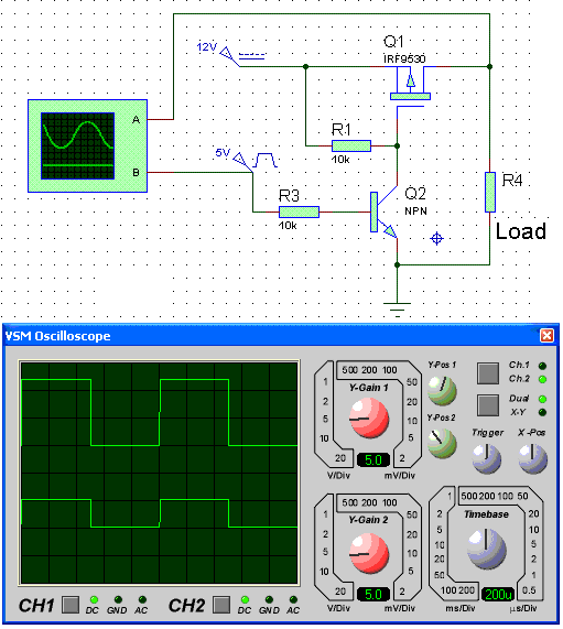

I need to switch on a couple power supplies with a 5V logic signal and want to do this with a MOSFET (for lower voltage loss than a BJT). The first is 3.3V at 5A max, and the other is 12V at 1A max. But I'm not sure how to design these switches and choose the MOSFETs. Can someone here help me with this design or know of a link that will teach me this. Thanks.

Here is one way to do this with a PFET.
Interesting statement. I always felt that it was based on the control voltage only (Vgs???) and not the *controlled* voltage.
The way this circuit works, the source of the FET is tied to the supply. If you only have 0V available with a 3.3V line then the g-s voltage will not be enough to switch the device on properly.

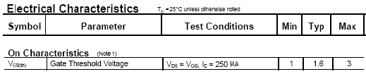

A word of caution here. If you look at various logic level MOSFET specs, the gate threshold typically can be as high as 3.5V and as low as 1V. At this threshold only about 250uA of drain current is measured at about 10Vds at 25 deg C (gets worse at higher case temperatures). Unfortunately no manufacturer can guarantee what it will be. That is why they quote a min and max threshold. So if it is your unlucky day you may end up with some 3.5V devices. Definitely not the chance I will take to design such a device into a product for production with only 3.3V to switch it with.

I don't understand your reasoning here. Looking at a spec, which spec is very well controlled, the 1,1.6 or the 3V?
If someone is a optimist he will like to work with the 1V spec. Me as a pessimist and designing for worst case would like to work with the 3V. At least I will feel confident that it will work very-very close to 100% of the time in my application (production).

TheOne, thanks for the circuit... it's small/simple, and my switch-on signal is already active low, so I guess I can eliminate the NPN transistor. However, I'm interested in *how* this circuit was designed. Care to explain? So far any tutorials I've found on MOSFETS only discuss the design of these with holes and doping p-channel material, etc, etc. There is a big gap of practical design knowledge (that I'm missing) between that theory and a working schematic.

I think you already explained it yourself :lol: . The device switches because of the Vgs difference. If you could pull the gate of a device on your 3.3V line below zero w.r.t the +3.3V it should switch just fine. If the device is used in fast switching applications with high currents, voltages, like in UPS's SMPS etc. then the gate drive calculations needs more careful attention.
