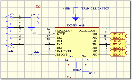

Now that I'm at it...is there a way connecting the servos to the rs232 ...i.e getting the power from the seriall port...cause that would be smother..right? But as I understood so far...the seriall port can oscillate..up and down in voltage...thus I need to have a fix 5v from it...how do I do that?
this is the controller I built (not my design though)...
i dont't think you should take 5v from your serial port, it might not be abel to deliver enough current to the servos.
instead take power from the PSU, It'll be easy too
