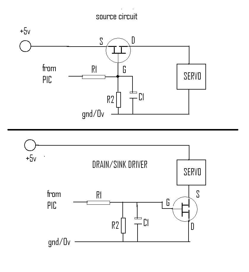

Hi John
Thanks for your quick reply, and info. If I have understood you correctly, I may be better using the drain circuit method.
I have attached a quick sketch of both the source and drain/sink with what I think is required.
I would very much apprecirate it if you could check them over and if possible if you have an idea of the R2 / C1 values, that would be great.
I only want to prevent the MOSFET from switching during PIC start up, hence the thought that a capacitor may just reject any spurious signals.
I was thinking of R2 being around 1K (with R1 being 100R).
I'm only vero building at the moment, so I think a TO220 style would be better, also, I don't think it would need a heat sink as the power is only higher during the short period that the servo motor is driving to its balance position. Thinking of trying the IRLZ24PBF from Farnell (Part # 1350883) ... and cheap enough at 49p.
Roy

Two things:
1) The "mosfets" in your schematics are connected backward. In the drain/sink model, that should be an N-channel and the Source goes to ground. See Fig. 10a for the IRLZ24 datasheet. That configuration is often called "low-side." In the other (P-channel model), the Source goes to V+, and it is called high-side.
2) I have never used the capacitor you show (C1). It will certainly slow gate turn on, but may not be needed. I have used the resistor to ensure the gate's state is known while the PIC turns on. As a rule of thumb, I have used a value of about 10X the gate resistor. It is certainly easy enough to determine if the capacitor is needed in you application.
John

We are talking about two different resistors: 1) The resistor from the gate control switch (i.e., PIC in your case) to the gate; and 2) The resistor to ground (for N-type) or Vcc (for P-type) that is to ensure the mosfet is off at the start.
The first resistor is needed for two reasons: 1) to prevent oscillation of the gate when it is switched on rapidly (i.e., the gate is a capacitor and there is always resistance, so you have a potential RC oscillator); and 2) to limit current from the PIC pin. Gate resistors for the first reason are typically a few ohms to 20 ohms. The second reason is for the larger (e.g, 200 ohm) resistor.
The second resistor is to ensure a known starting state for the mosfet. In the circuit as you show it, it acts as a voltage divider. That is why I suggest a 10X ratio.

I would normally make "R2" at least 100x to 1000x "R1", e.g. 2k2 (2.2k) to 22k. I would use lower values only when speed is an issue.
... and completely kick out the electrolytic caps connected to the gates.
You want to switch fast, not slowly I guess.
Thanks the info all,
I'll try it without the cap first.
Switching speed is not an issue, as the MOSFET is only 'holding off' the supply to the Servo motor until the PIC has fully initialised, then the output will be turned on, and will remain on until the power is removed again.
I was only thinking of the Cap to reject any spurious signals on the PIC pin that may be present due to it being high impedence during start-up, but as you say, it probably is not needed.
I'll try different values in the R2 leg to find the most suitable.
