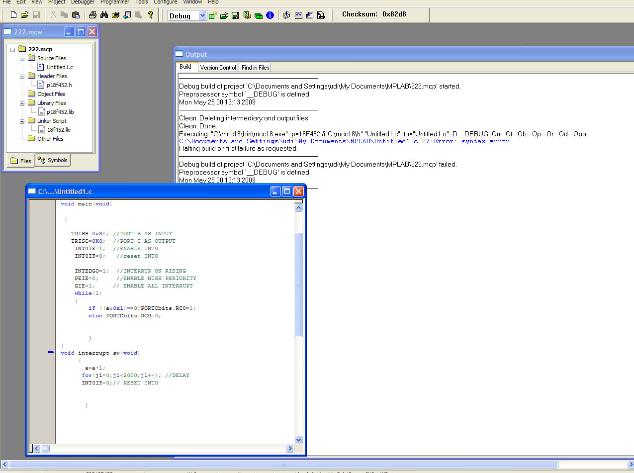

the error is in the line with the "void interrupt sw(void)"
any suggestions ?

The problem is you can't declare interupt to have no value (void interrupt) and use the return; statement. Remove the return statement. If interrupt were to return something you would change the line to something like char interrupt. Don't do it though, you shouldn't call the ISR from your mainline code.
Edit: Looking more at the function of your code I have to say you really shouldn't just sit in an ISR as a delay, there are better methods. Any interrupts that are supposed to occur while it;s just sitting there will be ignored. If you're counting on a timed interrupt to give you specific delays the method you're attempting won't work. I could really go into a lot of boring detail here but it'd be better just to hear from you what you're trying to attempt and letting us guide you to good code.
o.k
i removed the return line , but still got the same "syntax error".
the program have to increment 'a' by 1 on evey press.
i didn't understand what it is ISR but if you meant the delay loop, it is the insterction that we(our class) were told to do from our guide.
this our first program with interrupts.
thx for the reply...
*attaching screen capture , i am suspecting maybe it is the compiler ?

Try this.
#include <p18f452.h>
#include <stdlib.h>
static volatile unsigned char a=0;
static volatile unsigned int j=0;
void interrupt sw(void)		// Interupt Routine - ISR
	a++;			// Increment a
	for(j=0;j<2000;j++);	// Delay
	INT0IF=0;		// Reset INT0
void main(void)
	GIE=1;     		// Enable Global Interrupts
	PEIE=0;    		// Enable Periphial Interrupts
	INTEDG0=1;		// Interupt On Rising Edge
	INT0IE=1;		// Enable INT0
	TRISB=0x3f;		// PORT B AS INPUT
	TRISC=0;		// PORT C AS OUTPUT
	while(1)
		if (!(a & 1)){
			PORTCbits.RC0=1;
		}else{
			PORTCbits.RC0=0;
Of course you can. 'return;' is not returning a value, it's just an early return from function statement.
If this page [https://www.xargs.com/pic/picc18-vs-c18.html] is valid, it looks like you're using the wrong syntax to declare your ISR. Use the c18 syntax, not the PICC-18 syntax.
Also, check out the MPLAB C18 manual, or even the quick reference [https://ww1.microchip.com/downloads/en/DeviceDoc/51225c.pdf] for how to declare an ISR.
In fact, try some of these: mplab c18 interrupt - Google Search
My mistake.

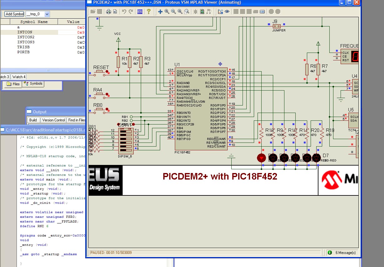

i know i should change the 'time' function for my case , but i first want that the INT1(switch number 1) interrupt will work.
uploading the picdemo board as it seen in proteus...
again thanks...

It might have something to do with the fact you copied and pasted the same code for sw and time without altering
INTCONbits.INT0IF=0;// RESET INT0
in the time section to
INTCONbits.INT1IF=0;// RESET INT1.
Also if I'm understanding what you're trying to do you can't give delay a cont value
PORTCbits.RC5=1;
delay(0x3000);
You need to make delay carry a value that's altered in the time function as desired.
Another issue is that you're declaring unsigned char a; globally and using it in two interrupt routines. If that's intended then ok but in case you weren't aware of the issues that it could raise I figured I'd bring your attention to it.
the delay function gets an 'int' variable so it is possible to send number,
the program works fine, but my problem that interrupt (INT1) is ignored
i am tracking it with breakpoint on the first 'if' condition. by pressing the RB0 button the program jump to 'void high_vector' , but if i turn on and off the switch that connected to RB1/INT1(can be seen in the picture.) the intrurrped is ignored and i don't see any break at the breakpoint.
**again i know i should change the time function for my purpose but for now i just want the the function will work.
....i know i should change the 'time' function for my case , but i first want that the INT1(switch number 1) interrupt will work.....
....**again i know i should change the time function for my purpose but for now i just want the the function will work.....
I miss-interpreted what you meant by that, sorry.
Try adding RCONbits.IPEN=1; to your main function, by where you put INTCON3bits.INT1IP==1;.
Edit: I just noticed something
    INTCON3bits.INT1IE==1;
    INTCON3bits.INT1IF==0;
You're using two = = signs to assign a value for the INT1 control bits, try this
    INTCON3bits.INT1IP=1;
    INTCON3bits.INT1IE=1;
    INTCON3bits.INT1IF=0;
If that doesn't work try what I suggested above.
still not working ... :confused:
