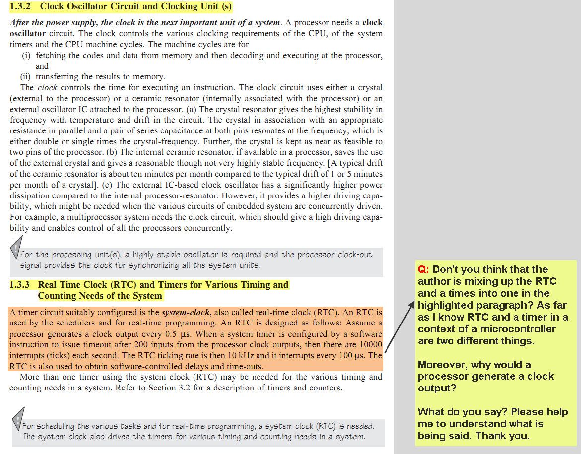

Hi
Could you please help me with this query? Thank you.
Regards
PG

Haha.. that paragraph is bananas. Next time mark it with thick black magic marker :)
- RTC is a clock that counts seconds, minutes hours etc. standard time (for humans). The author is mixing real time clock and real time scheduler (real time scheduler uses system-clock).
- RTC can be used by schedulers and real-time-programming.
- RTC can be used to obtain hardware controlled delays, interrupts and time-outs.

The processor uses crystal oscillator to time its working. Could you please tell me What system-clock is in the given context? Isn't **broken link removed** implying that crystal oscillator and system-clock are closely related. Thanks.

Crystal oscillator provides the clock that makes the processor work. Instructions are executed in the processor each clock cycle. All timers, counters etc. use the crystal oscillator to work. The context here is a real-time-system. Which means that there are things that needs to be executed at specific time events. These events are controlled by the system-clock. In this context the system clock is not the clock that makes the processor work, it is the clock, or timer, that times the events needed by the real-time-system.
Usually in a real time system a timer (counter) is set up to count up to a specific value. The counter counts at the crystal oscillators frequency. When the counter reaches the specific value, an interrupt is generated (by the hardware) and the time critical task is executed (in interrupt handler, which is software). At the same time the counter value is set to zero (by hardware) and it starts to count again. All this counting and interrupting is done by hardware in the background. This counter is referred as the system-clock (in real time systems.. or real time schedulers).
Sometimes.. actually many times.. the crystal oscillator, or whatever oscillator, is called the system clock. But in the context of real time schedulers it can be the timer that times the time critical events. And that timer is clocked by the (crystal) oscillator.
The text in your **broken link removed** is weird.. He is explaining a simple thing overly complicated thinking that it makes it easier to understand.. It doesn't! "high and low pulses"? They are just pulses. Crystal oscillator output is actually a sine wave.

Having got the humour out of the way for this morning, a lot of that text about oscillators and clocks is just plain mis-guided to the point of being wrong in places.
System Clock - provides pulses to tell the logic when to change state. Can run at any speed within reason, does not need to be particularly stable unless the processor is doing something which is time critical.
Real Time Clock - Tells the time.
Usually separate from the system clock, keeps time when the rest of the system has no power.
This is a big subject with a lot of ifs and buts.
I think that the author of that book has tried to cram too wide a subject into a couple of paragraphs and reduced it to absurdity.
