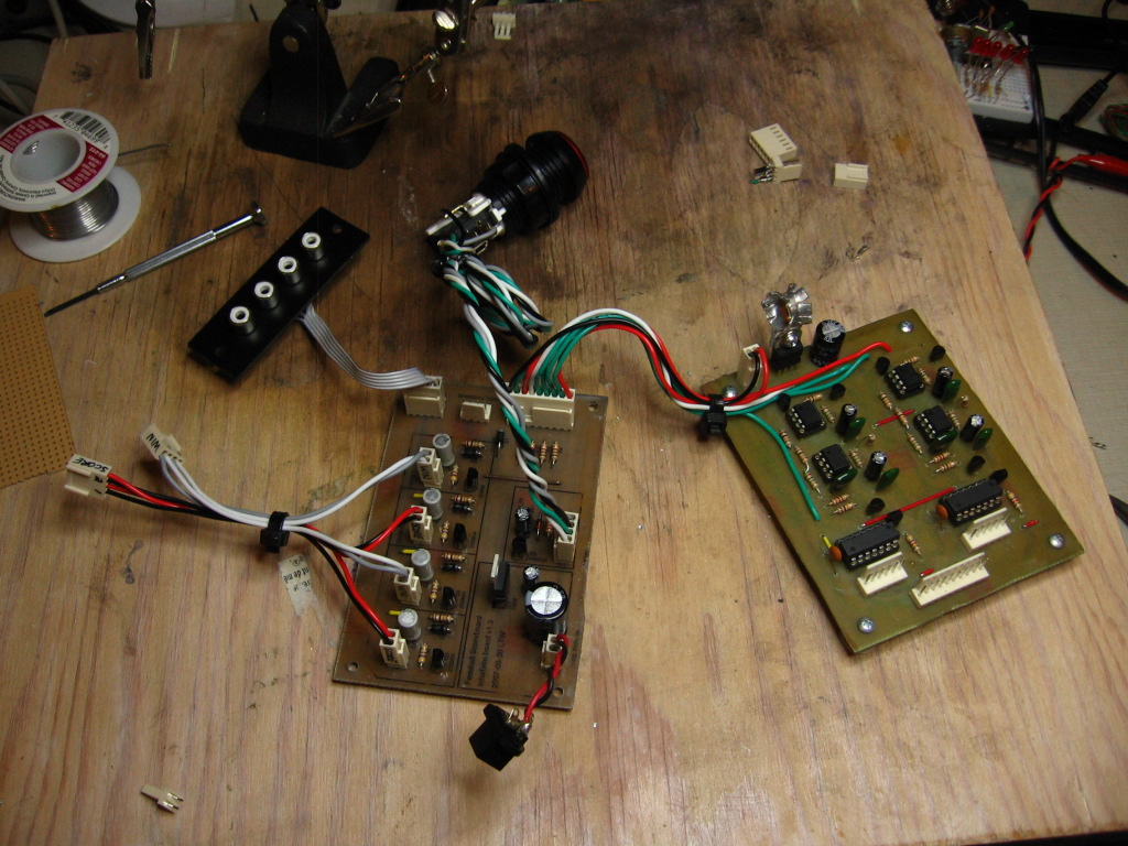

I'd agree. I built my first digital circuit (a foosball scoreboard circuit) using TTL logic over the past couple of years. It is big, slow, and uses too much power--but it does work.
It took ages to design and I had a ton of help from Ron (Roff) , Eric Gibbs, Nigel, audioguru, and I'm sure many others I'm forgetting right now. I learned a lot--enough to know that while it was a fun project and I learned a lot, it would be much faster to build, debug, design, and modify after the fact by using a microcontroller.
I've attached a photo of the completed boards. Ron, you can see the differentiators you instructed me on, on the left-hand board (four identical subcircuits with pigtails for the score/win lamps and RCA outs for the SPD-20 triggers--thought you might like to know I actually used the help you so patiently gave me.)
Torben
[Edit: I need another coffee. Ron hasn't posted to this thread at all. :)]

It still looks good anyway.
What did you use to power it?
I suppose a wall wart or large sealed lead acid battery are the only viable options.

Thanks Hero,
I put a wall-wart type plug on it and used a 12V 1A linear supply I'd built for something else (a Fostex 4-track recorder I never got around to fixing).
Torben
