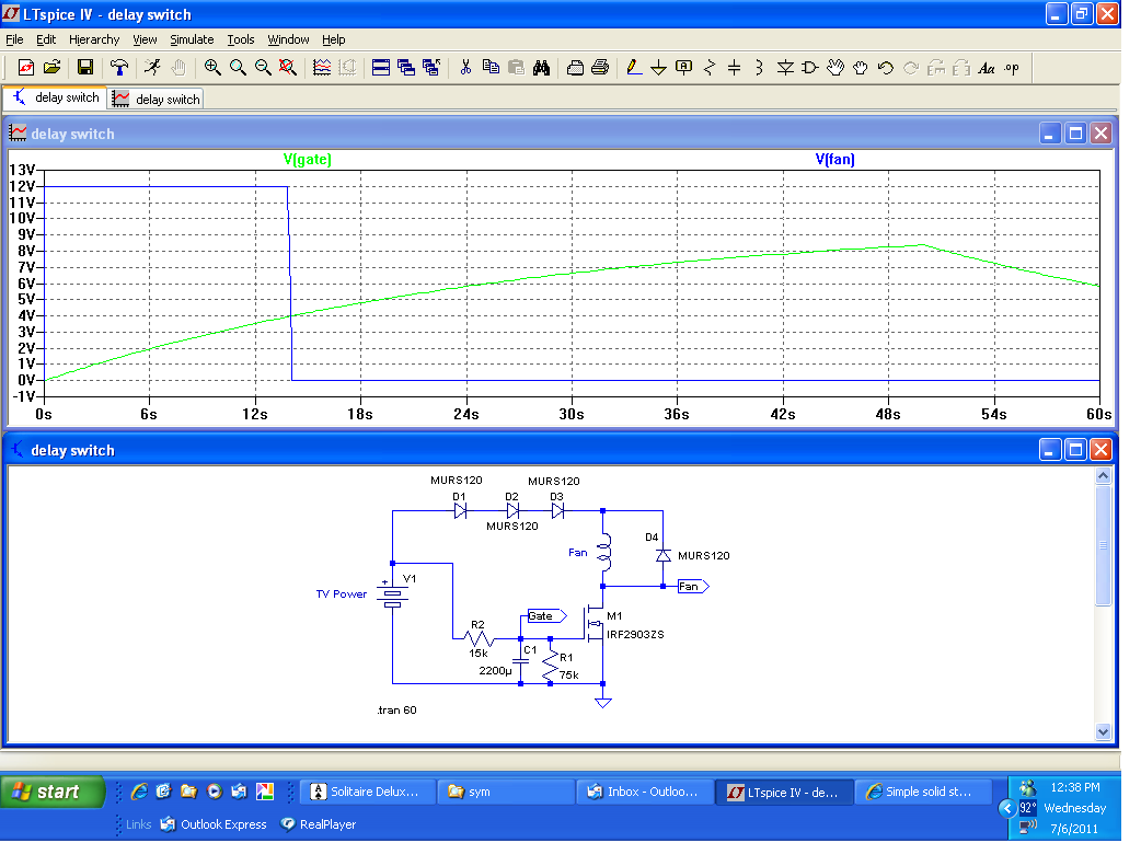

Hi, I'm new here and I'm hoping someone with a tad more knowledge than myself can help me with a circuit I want to build.
I'm adding a small 12VDC fan to my LCD TV. I want a 12V supply from the TV PSU to power the timer input and the output for the fan. After turning the TV on the 12V would go to the timer delay and after maybe 30 seconds it would then output the voltage to the fan. If possible I would also like the output voltage to be around 9V so the fan is running slower and therefore slightly quieter, although this isn't paramount. The circuit needs to be solid state as I don't want to use a relay.

@ ronv - yeah, the fan is 0.2A, although I may want to use one slightly larger so I am looking at allowing for 0.4A. Reason for the delay is because the simultaneous TV switch on and start of fan is causing the Protect_Detect circuit of the TV to operate, whereby the TV then goes into fault mode. After a little experimenting I reckon a 10s delay will be fine.

I hope you will like this. C and VR will do the delaying and set schmitt trigger inverter output high to make the MOSFET conducts after a delay period. I guess you can find the value of C, VR, R1, R2 and appropriate MOSFET. Good luck
Fan delay
I think this will work. The diodes could be replaced with a resistor, but you may have some problems getting the fan to start.
AWT, That is a nice circuit, but the NFET won't work good in that circuit.

@ ronv - I'm no expert myself but are the voltages displayed at the top of your attachment the wrong way round? Is gateV not the blue trace and fanV the green trace?
No they are correct. The gate rise time is very slow - this creates the delay, but the turn on time once the threshold is obtained is still fairly fast as in the simulation.
OK thanks. Guess I will have to do some extra reading on Mosfets, gates etc.. Although I do have electronics knowledge (self taught/learned) I'm only at a basic level but it does help me enjoy building my own circuits/mods for whatever the project may be. I've just repaired the TV in this project (lots of bad/dry joints, leaky electrolytic on PSU) and after seeing how hot the main processor was getting (more dry joints on adjacent SMD components) I decided on this fan addition.
Anyways, would you mind giving me a brief description of your circuit so maybe I can try to get a better understanding?
R2 charges C1 untill Vgs > Vth of M1 (See datasheet)
M1 turns on rather slowly. D4 absorbs inductive spike from the motor.
D1, D2, D3 reduces the motor voltage by 3 diode drops (3*~0.6V)
R1 allows a way for charge to deplete and aids in discharging C1 at power off. at~ 5*R1*C1 seconds, the cap should be totally discharged.
