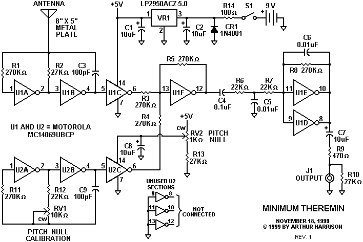

Here's a circuit you may find interesting.

Very interesting :D
I have some hex invertors, but I imagine you need that very particular number for that application, probably because the high frequencies involved. Is that still the same RF operating principle? I imagine the main difference is in the output waveform, more square than sine I would think.
I dare say it will sound a bit different to the "classical" theramin.
On the plus side it does use elements that are readily found, the inverters are drawn merely for simplicity as they could be actually made from other types of gates with an inverted output , as for the 4069 specified in the circuit there is nothing special about it. The oscillations are well inside the upper limit for off the shelf logic chips and audio amplifiers, the oscillator stages could even be replaced with a pair of 555 timer's , a nice touch as it would allow you to experiment with changing the mark-space ratio of the square wave thus altering the sound characteristics.
Well, that does look like a better one to try, cheers.
Still, i'm not totally sure how this works. Does it use radio frequency signals? I don't imagine it can because they tend to be 100Mhz+, and CMOS won't work at that frequency. If it isn't, how does the plate affect the frequency? Still to do with capacitance?

It uses two RF oscillators, exactly the same as the other one did - as far as I'm aware theremins don't use VHF?, they use much lower frequencies, probably in the low single MHz region.
Using VHF would produce much too great a frequency change, and there's no point producing notes higher than human hearing :lol:
As you suspect, the capacitance of your hand near it alters the tuning of one of the RF oscillators.

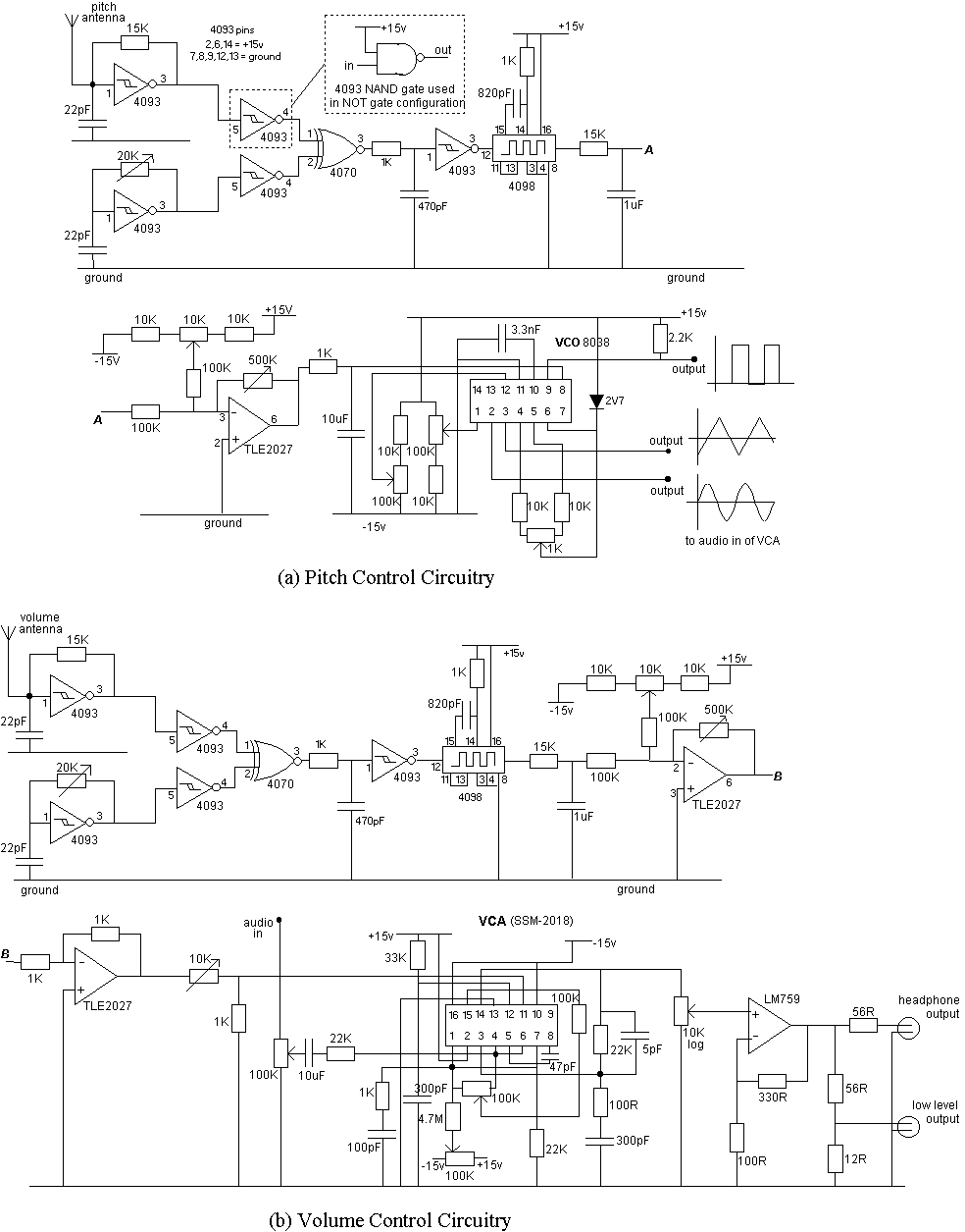

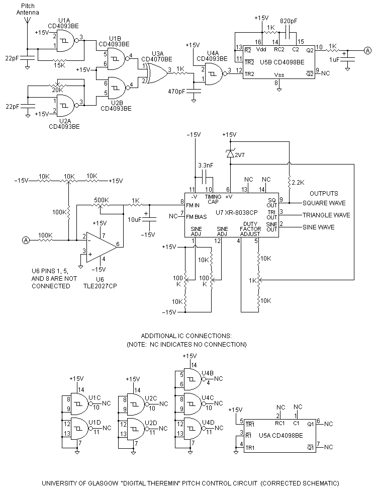

this is the revised pitch with corrections. sorry for the previous double post but hav an unstable connection
Thats neat, but might be a little complex for me. I see the advantage of this is that it has better sounds, and a VCA. But, I was thinking, if I got that "mimimum theremin" working, I could surely connect the output to a frequency to voltage chip and use that output voltage on the CV input of my synth, and hey presto, a synth played by a theremin! Would make an interesting control system I reckon :lol: . Can't see why that wouldn't work with a little tuning.
well u have two distict sections there the pitch and volume so u can mess with them as u please and maybe make some interesting combinations. i mean think of feeding a radio or other device into the volume section.
i saw another all transistor project that said to use u guitar volume pedal but i think that was a simple get away and no longer a decent thing. this project i read is more stable especially as ther is no LC circuit that can get tricky. note that the two oscilators of each section r made with seperate chips although the four gates r enough for both i suppose this is to minimise interference. this only shown on one diagram (the revised pitch one) but it is probably advisable for both.

Hi Dr. EM,
The oscillators in the Minimum Theramin operate at only about 200kHz so just about any CD4069 inverters IC will work.
Stripboard will be fine if you use short length tracks and cut unused lengths.
I haven't heard of that low-dropout 5V regulator but there are many available but needing a 100uF output filter capacitor. A 78L05 will work only when the 9V battery is new.
The lowpass filters gradually reduce audio frequencies above about 300Hz, so bass tones will be buzzy and treble subdued and flute-like. :lol:
