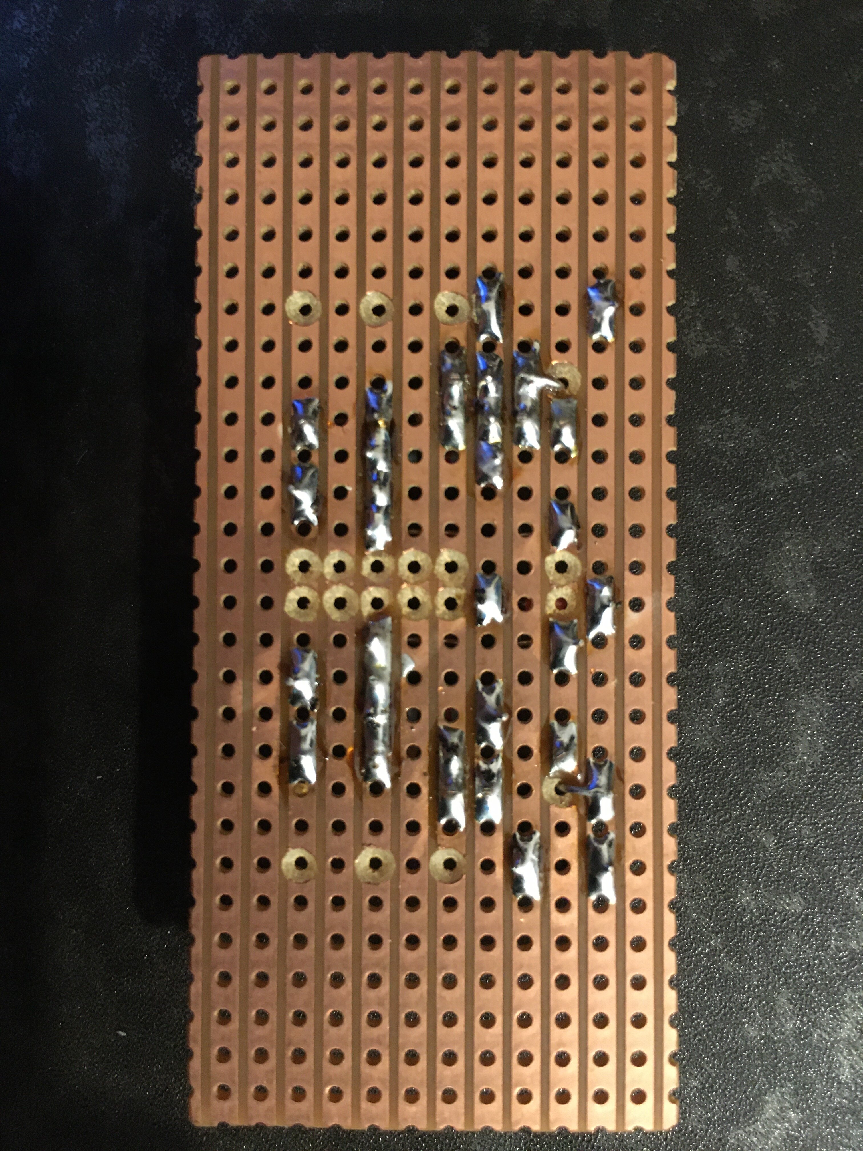

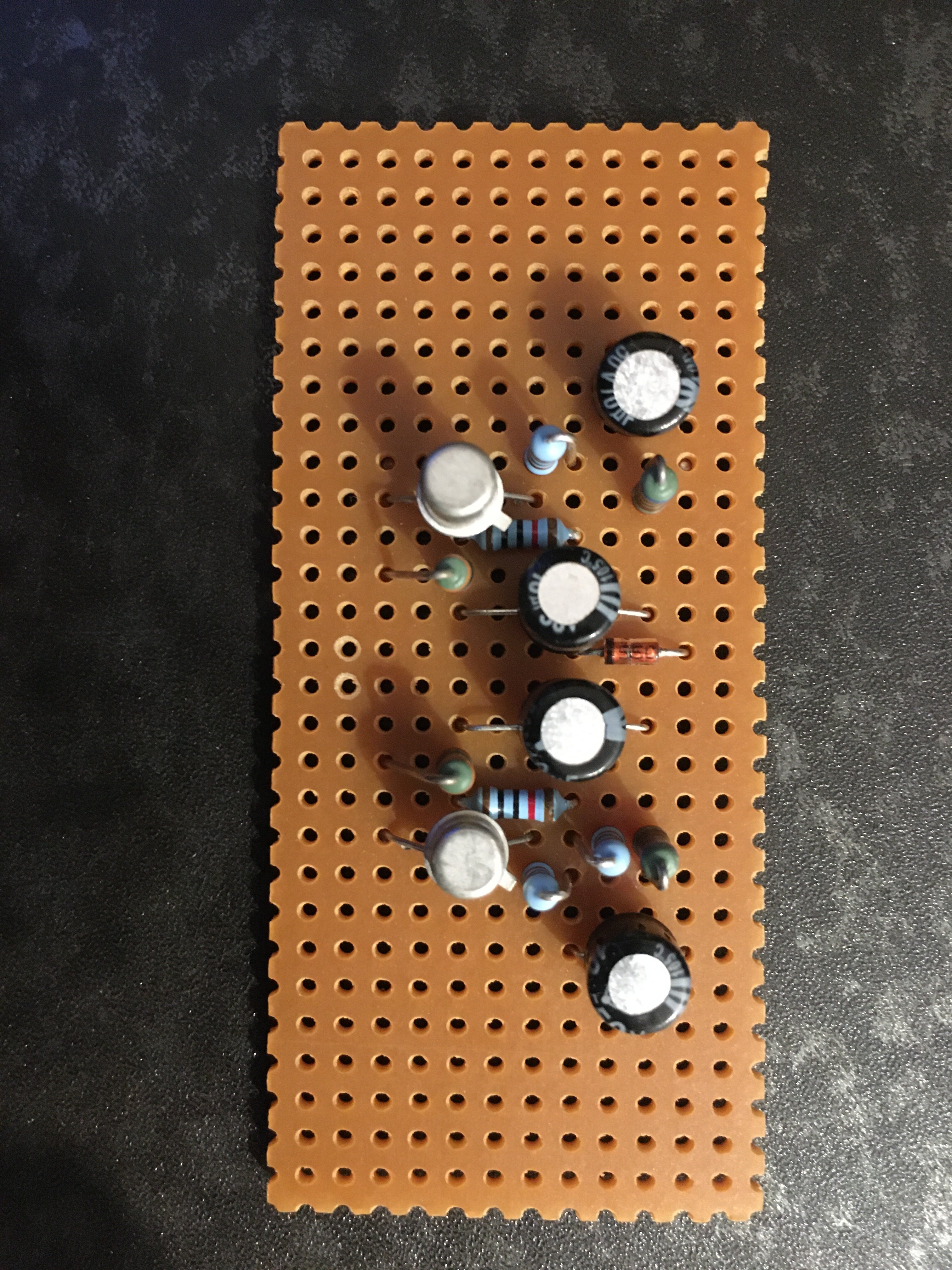

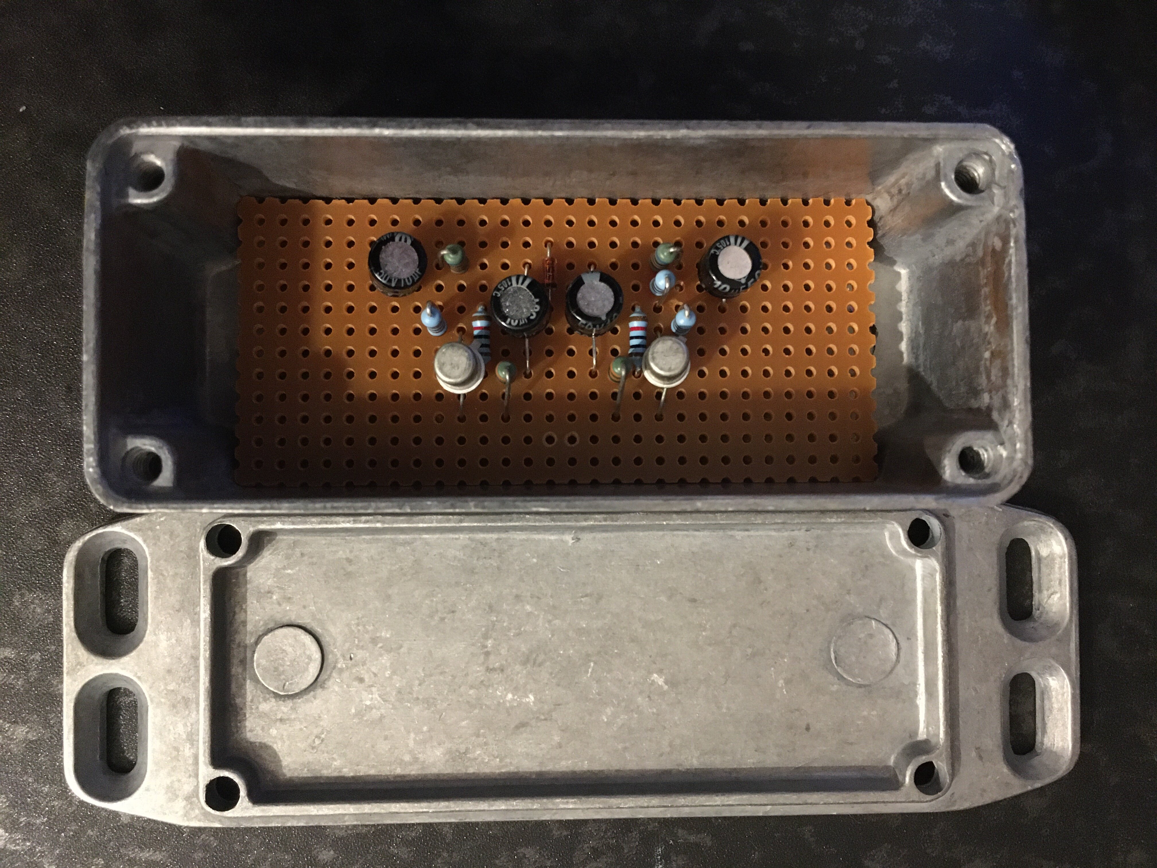

Photos of one of the originals, if you want to build one; I made a batch originally and had a couple left over.
They were made to fit in flanged die-cast boxes for protection and screening, around 90 x 35 x 35mm not counting the mounting flange.
The BC107 is long discontinued. I'd use ZTX851 now, they are superb ultra-low-noise transistors when used in such circuits.

I'd use A for signal and C for mic ground, in my version. Also connect B to ground.
Having the mic screen connected to an input does not seem to be a good idea to me; it would probably be OK with a bare mic capsule and direct connections but not with a cable in between, picking up noise.
In my version, you could also try directly cross-connecting the transistor emitters? That would convert it to a "long tailed pair" type configuration and it should then still give a reasonable balanced output from the single-ended input.
Looking at the bottom of the stripboard, the rightmost used track is ground [C], the two connections immediately to the left of that and just above / below centre are A & B and the leftmost used tracks above/below centre are the outputs.
Photos:
View attachment 125975 View attachment 125976
Thank you, these are very helpful. Oddly, BC107 is still available (and in stock) at CPC Farnell!

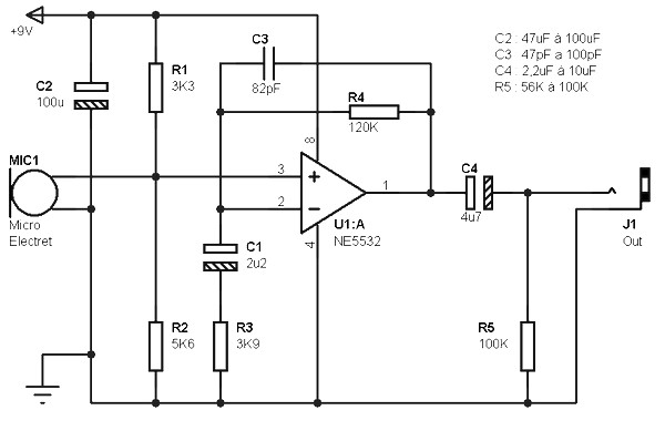

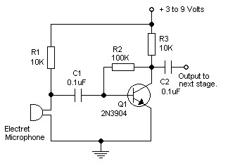

Yes, you need a preamp circuit for the mic. Think of the mic capsule as a 10 mV voltage source with a relatively high output impedance, that needsa few volts of DC bias to function. There are a zillion mic preamp circuits on the innergoogle, ranging from basic ( 1 transistor plus 2 resistors ), to a full-blown low noise "audio opamp" based audio console input stage.
I recommend against opening the mic capsule; partly because of your skill set, but mainly because there just is no valid reason for it. Let the mic be the mic; dealing with its quirks is not at all difficult.
Here are grabs from a search for "electret peramp circuit". On the left, note that R1 and C1 will be a part of any electret preamp, to bias the cartridge with DC and then remove that DC from the audio signal. The right circuit is more "audio quality", and takes a slightly different approach to DC biasing.
I must admit I am far more au fait with opamps than transistors, so I 'get' the second circuit!
