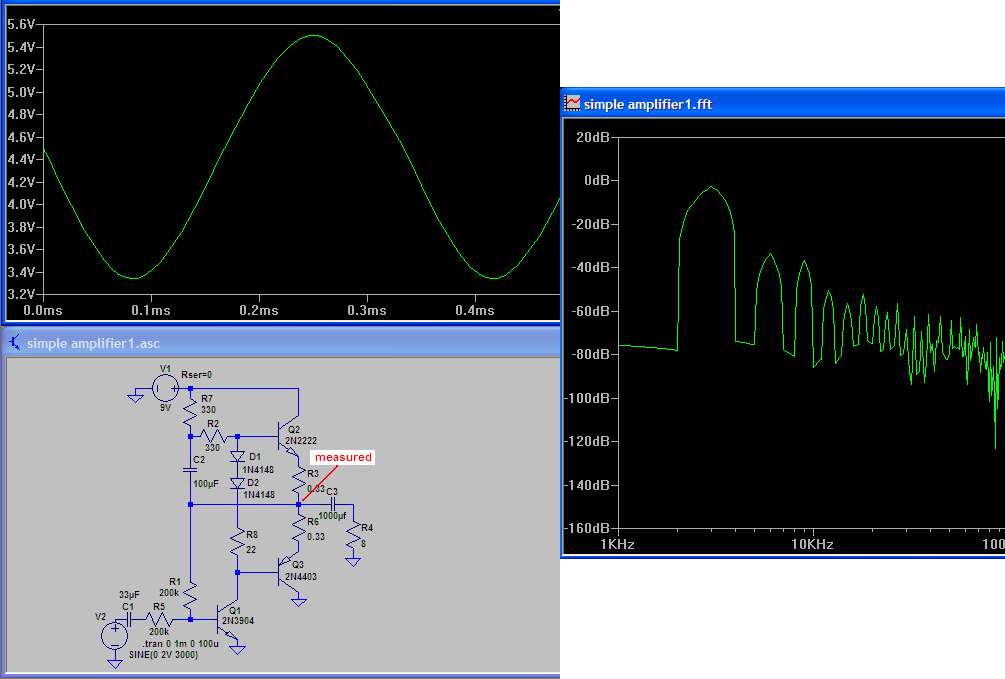

Playing around with this little audio amp, I came up with a nice simple little 3-transistor amplifier that drives a set of headphones very nicely.
I like it because 1) it's simple, 2) it only uses 3-legged devices, and 3) it can be built from parts in your junk box.
I listened quite a while with this running on a 9 volt supply, and it sounded good to me. It took a while to tweak the input attenuator network (R1 & R2) so that it wouldn't be too loud, the volume control would actually work (instead of acting as an "on-off" switch) and the input would be inaudible with the volume control at its leftmost position.
I actually ran this without any output coupling capacitors with seemingly no ill effects either on my headphones (mid-range Koss) or my ears, so I'm not convinced they're absolutely necessary.
I powered this with Mr. Al's simple 3V--> 9V boost converter, which worked great. (Had to throw about 1000µF of filter capacitor across the power rails to quiet it down.)
I was wondering about that too. The author said they could be replaced by a single resistor between emitters. In that case, does it matter where you take the output? It doesn't affect the symmetry of the output waveform, does it?
You don't need any emitter resistors as the two transistors are emitter-followers and there is a point when neither transistor is conducting so no resistors are needed (they are normally added to prevent high currents from flowing).
I simulated it. It has a voltage loss of 0.6 times instead of a voltage gain.
It has horrible distortion of about 3% near clipping.
It is biased wrong so it clips the bottom before the top.
It has crossover distortion if the 4.7 ohm resistors are removed.

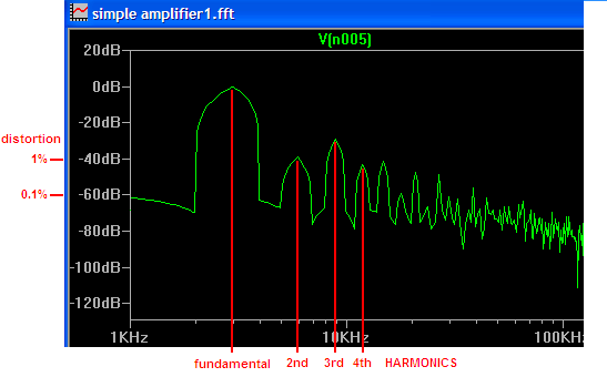

How do you know this? I don't see any distortion analysis in your simulation. Did you do a FFT analysis?
Again, how do you know this? The output waveform looks fine to me. And what level is the amp running at in your simulation? If it's working at the top of its lungs, then no wonder you're seeing these faults.
Many people cannot see 10% distortion on a 'scope but with my long experience I can see 0.5% to 1% distortion.
The FFT shows what I said: Lots of horrible distortion.
It is nowhere near clipping. It is biased wrong so its clipping is not symmetrical.

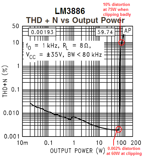

Normal amplifiers have almost no distortion up to clipping. The inexpensive LM3886 60W amp IC has 0.002% distortion at clipping.
So you're comparing my little 3-transistor headphone amplifier to a 60+W LM3886?
Yeah, that's a fair comparison! Sheesh.
The headphones amps at Headwize.com use an opamp with 0.00008% distortion and they add a load resistor so it operates in class-A for even LESS distortion. They are audiophools.
The LM3886 60W amp IC costs $7.30 at Digikey today.
A fairer comparison is the 1/4W LM386 IC that costs $.95 today. Its distortion is 0.2% at clipping into 8 ohms and nearly nothing when driving 32 ohm headphones (but it has hissss).

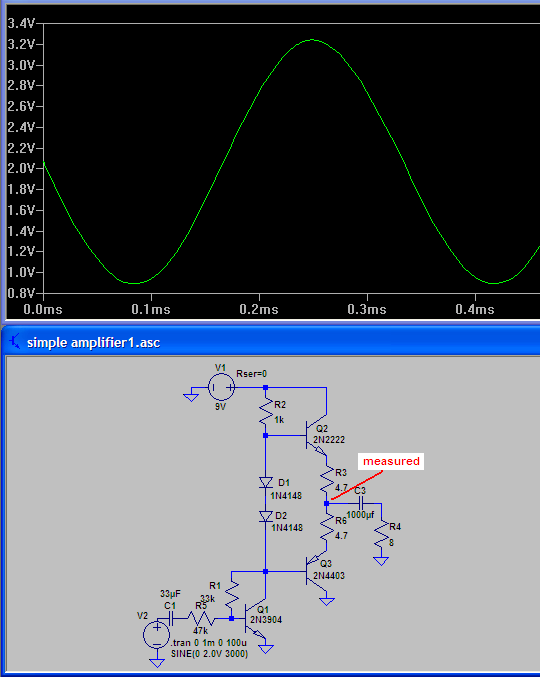

Audioguru, that was cool of you to build it in the simulator and run some tests and provide the feedback on it's failings.
I'm curious of what simple easy changes you would make to this 3 transistor amp to improve it?
Bearing in mind that it's easy to say "this amp sux" but people who open this thread based on the thread title may be genuinely interested in a simple cheap headphone amp made from a couple of transistors.
Without adding too much or changing it much what would you "tweak" to improve it?
I'm not the one you asked, but I removed the unneeded emitter resistors, and reduced the upper base resistor, which seems to help the asymmetrical clipping problem a bit:

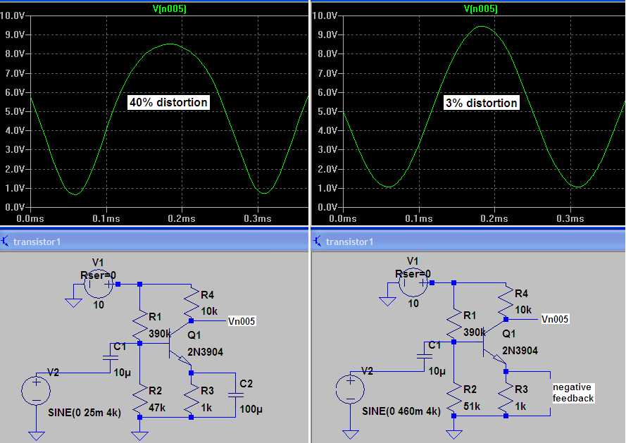

re; use 32 ohm load not 8 ohm; Then the distortion of my latest circuit is about half.
Well that should be plenty good enough then? How much fidelity is needed? I would imagine this amp would be used for non critical things like test gear, signal tracers, etc, any case where it's not necessary to use a HiFi quality amp chip?
Hi Mr RB,
Have you seen how much distortion is caused by a single transistor without any negative feedback and at high levels? The distortion compresses the top of the waveform so much that you cannot see how much voltage gain there is. That is one reason that opamps have so many transistors.
