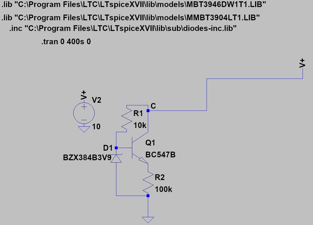

I have a requirement to drop a voltage from 5-36V down to 3.3V with precise (0.5%) accuracy. To do this I've used an accurate LDO (RT9050, 5.5V max) and a simple transistor regulator before it. The current draw is minimal, about 20mA max. The circuit was deemed "complete" and is about to be prototyped by a fab house. The one part I didn't check, because it simulated correctly in LTSpice, was the simple transistor regulator part.
In LTSpice the following screenshot works. I've swapped the transistor out to see how gain affects it but the voltage is stable.
Out of paranoia I built it on a breadboard and found a ~10V increase leads to a 1.5-2V increase on the output. Accuracy increases as the 10K base resistor decreases up to the point enough current is flowing through the zener to make the transistor rather pointless.
Given I have a 36V max input, that's about 6V variance on the output which will blow the precision LDO.
Can anyone explain what's going on, why LTSpice hasn't caught it (LTSpice shows only 0.05V delta between 10 and 30V input)?

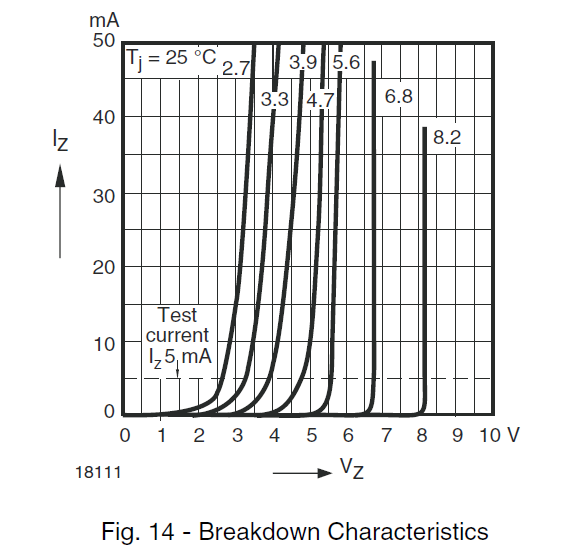

A 3.9v zener does not have a sharply defined voltage.
Look at Figure 14 on this datasheet: https://www.vishay.com/docs/85764/bzx384.pdf
With the currents you are putting through the zener via the 10k resistor, you will be operating on the knee of the curve.

My bench supply is only 20V so I couldn't tell if the voltage increase was occurring past this point, it looks like it wont. I'm also using a 5.6V Zener (mistake in screenshot) which with the transistor offers about 4.9V to the LDO. As long as it doesn't have a 0.6V variance (by increasing the resistor to say 3.9k) I should be OK?
((36-5.6)/3900 )*(36-5.6) = 0.23W dissipation (inside 500mW limits as I'm using BZT52).

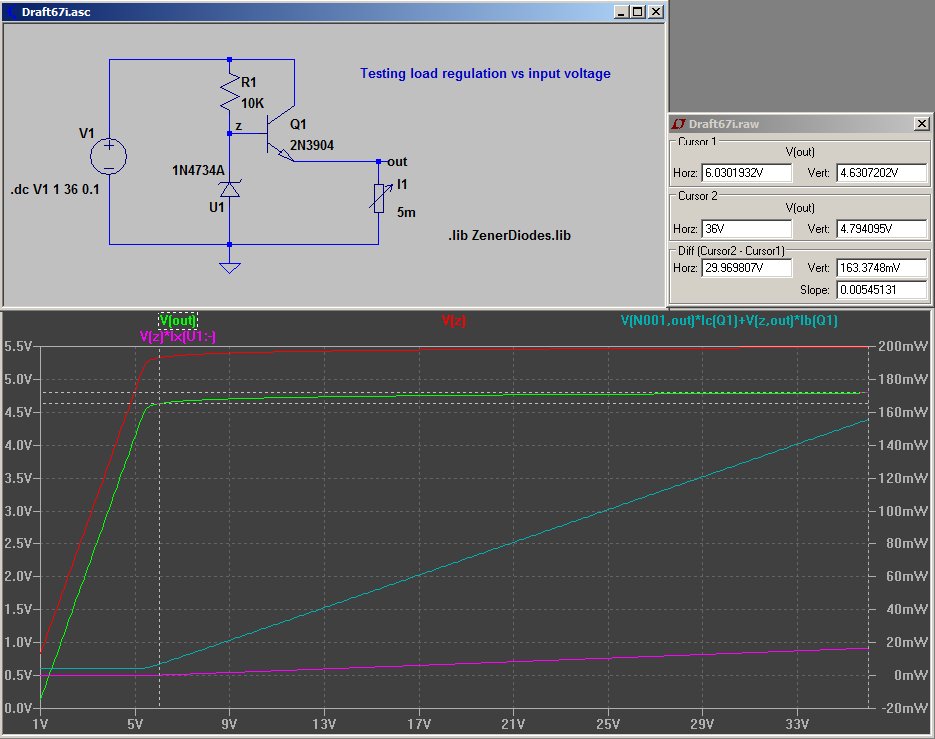

LtSpice showed only what you asked of it, but you didn't do the required steps to see if the regulator covers the range of inputs and expected outputs..., or if you are stressing any of the components...
First, here is how to use LtSpice to test the Output Voltage Regulation as a function of Input voltage, V1. The regulator has a 5mA load. The input voltage ranges from 1V to 36V (see X axis). You can see what the minimum input voltage for regulation, about 6V...
I plot both the Zener voltage V(z) and the output voltage V(out). Note that the regulator's V(out) changes 163mV as V1 changes from 6V to 36V, or 0.5%. I also plot the power dissipation in the Zener (<20mW, ok) and in Q1 (160mW which is getting up there).

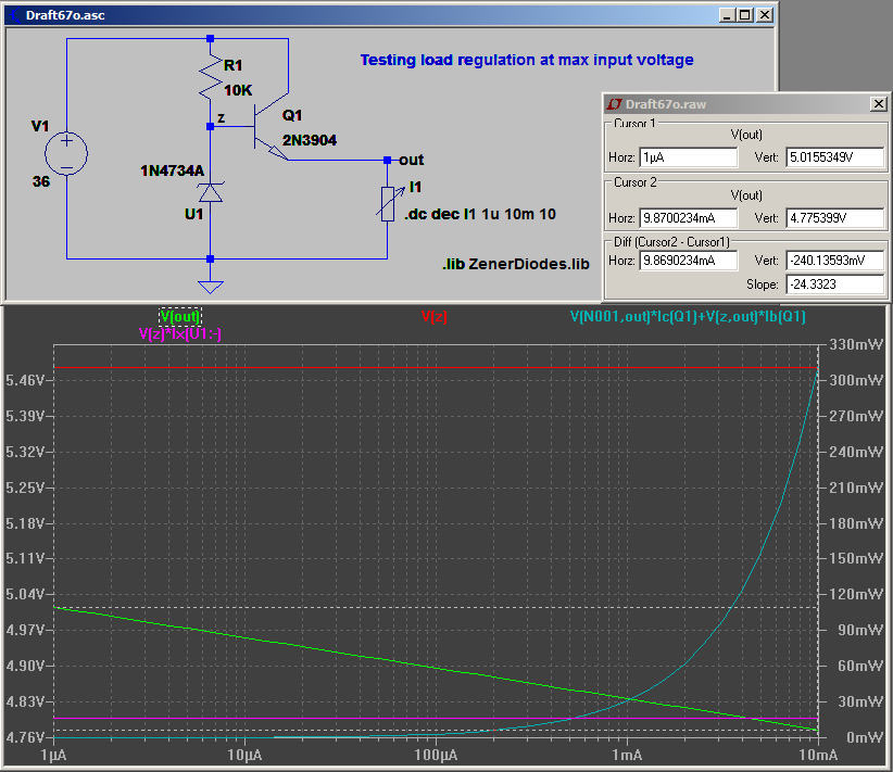

Second, here is how to use LtSpice to test the Output Voltage Regulation as a function of Load current. The input voltage is 36V; you might want to repeat this test at V1=minimum.
I vary the output load from 1uA to 10mA. The log of load current is the X-axis.
I plot both the Zener voltage V(z) and the output voltage V(out). Note that the regulator's V(out) changes -240mV as Load current changes from 1uA to 10mA. I also plot the power dissipation in the Zener (<20mW, ok) and in Q1 (310mW which is quite high for that transistor).
Usually a simulation uses only "typical" spec devices but in the real world some have minimum specs and others have maximum specs even if they have the same part number.
The datasheet shows you the wide range of "dynamic resistance" of the zener diode which affects its ability of voltage regulation. Heat also affects the output voltage that maybe a simulation ignores.
