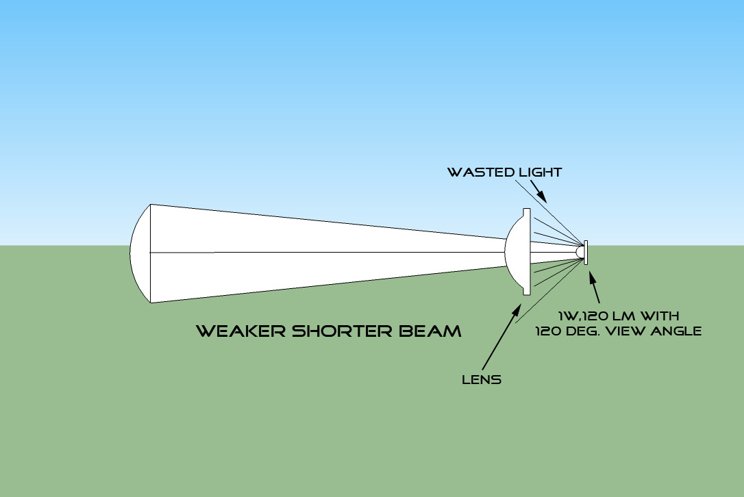

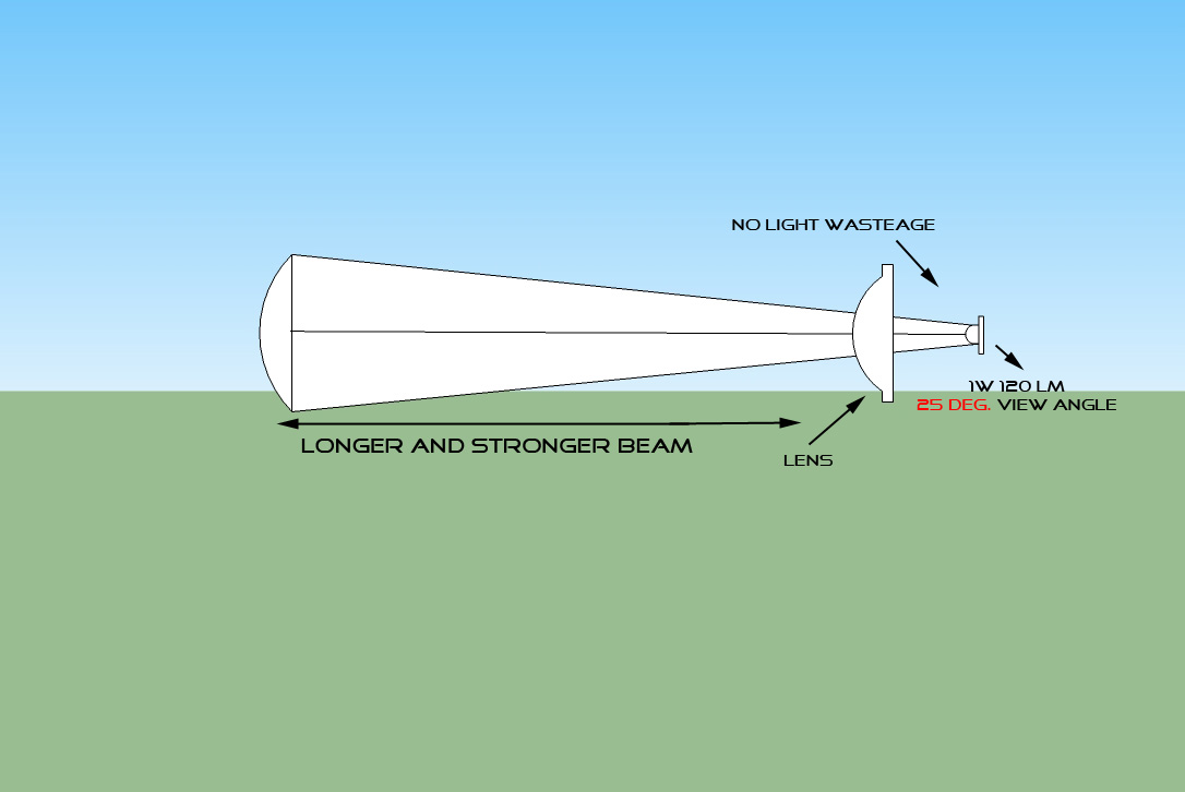

I got Power LED with 25 degree View angle from Taiwan and Aspheric Lens from China to use in front of the LED.
tested 1W LED already and it gives very attractive light output with lens. more thn any other available light in market or . as they all using wide angle LEDs in their Torch and most of the light output is remains unused. see Pic. attached.( I also tested normal LEDs with wide angle) output was not good compare to narrow angle LED.

Wide angle led:
Narrow angle led:
