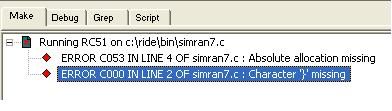

what is wrong in my this program... see...
#include<reg51.h>
void main(void)
  sbit ravi = P1^0;
  while(1)
  ravi = 1;
  ravi = 0;
the error i am getting is :
I'm sorry but I'm not familiar with 8051. My guess is that the above should be,
#include<reg51.h>
#define ravi P1.0     //ravi = port1 bit 0
void main(void)
  while(1)
  ravi = 1;
  ravi = 0;
____________________________________________________________
#include<reg51.h>
sbit ravi = P1^0; /// define the port out side main....
void main(void)
while(1)
ravi = 1;
ravi = 0;
the cycle will be so fast that you will not see any change externally .........
better give it a try with a delay in between them

#include<reg51.h>
void main(void)
sbit ravi = P1^0;
while(1)
ravi = 1;
delay ();
ravi = 0;
delay();
__________________________________________________________________
So Mrs Simran
You might have got the correct reply for the above
you should add delay
