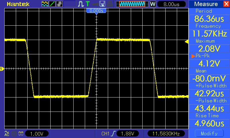

Below is a sample signal I am generating using a capacitive soil moisture sensor soaked in water.

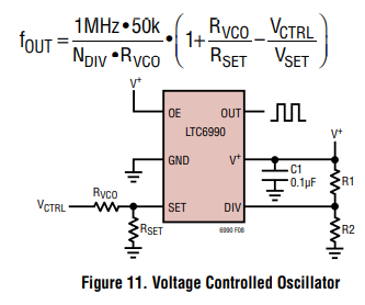

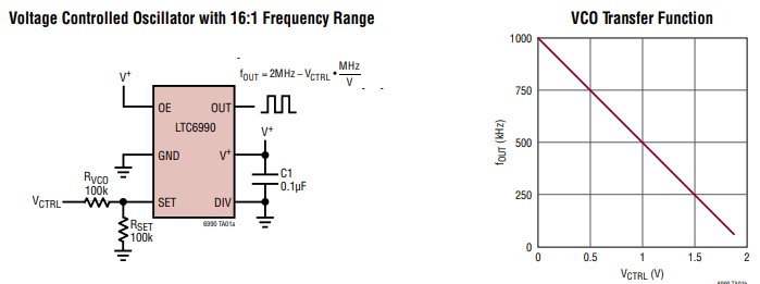

Here is a very small voltage controlled oscillator. LTC6990
By adding R1, R2 below it will work from 488Hz to 2MHz.

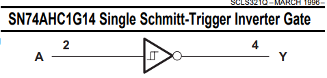

Here is another very small IC. One inverter.

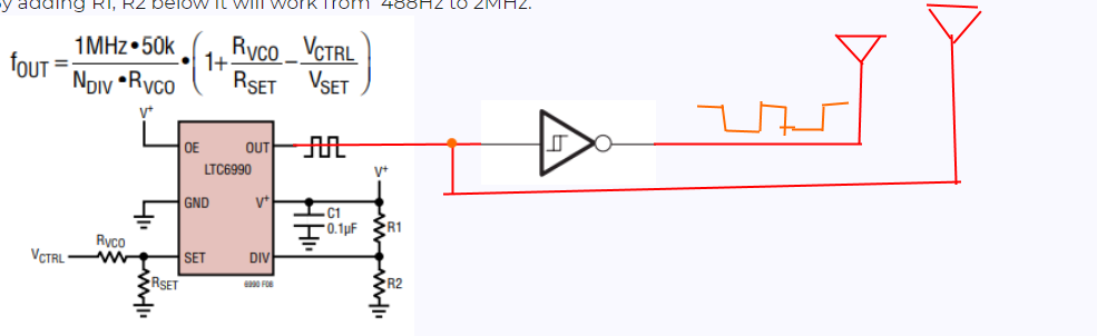

Here we have two outputs. One is 3.3V/0V while the other is 0V/3V so the total output is 6.6Vp-p.
This much could be built on a PCB the size of your coin cell.
