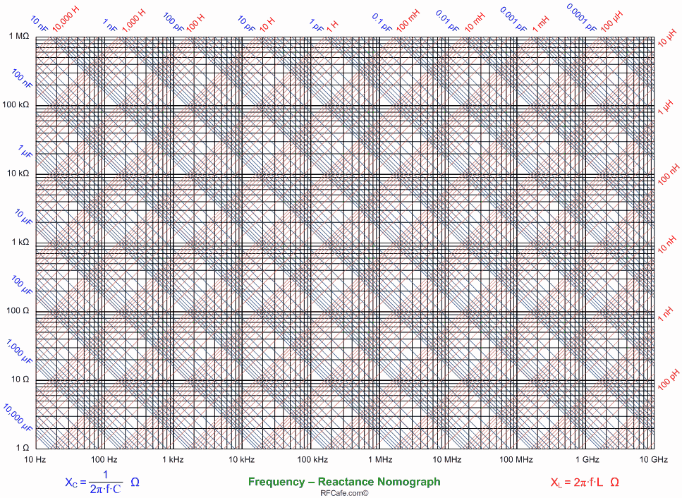

given the 22pf tuning cap and 100Mhz as the center of the band, ...
1) the cap will be about 12-15pf at center tuned position
2) center of the band is 100Mhz
3) find the inductance that resonates with 15pf at 100Mhz
4) result is 150nH .... went to an inductance calculator page and entered the following, coil diameter =8mm (about correct if you wind the coil on a #2 pencil ), number of turns=5, length of coil = 12mm, wire diameter 0.5mm (page script changed it to 0.55), and design frequency 100Mhz. these figures got the coil almost correct for inductance at 125nH. if you squeeze the windings a little closer together you will get 150nH or add one more turn and stretch them out a little...
