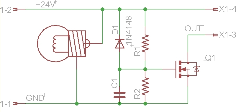

I do not fully understand but......
Here is a way of getting each light to turn on after a delay. Sorry no micro.
When 24V is applies the light bulb turns on. Then after a RC delay power is sent on to the next stage. R1=R2 (1mega ohm?)

I am still thinking about it and brain storming. Trying to come up with the easyest way to signal the next timer using just the power wires.
