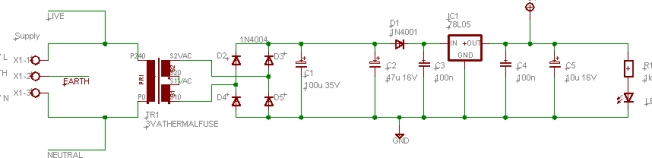

Trying to simplfy a psu (shown in the image). The supply is 240VAC @ 50Hz (UK Mains) and the output is 5vdc @ aprox. 100mA.
I thought of using some sort of line attenuator / zenner arrangement that will replace the expencive and bulky transformer, to directly derive about 24Vdc from the bridge diodes for the input of the VReg.
Is this possible? the 5V output must be provided by a vreg becuase it needs to be stable for a uProcessor is attached to it.
Can anyone come up with some design ideas / circuits?

The transformer is there for two reasons:
It is an efficient way of converting the mains voltage to the low voltage required for the rectifier and regulator.
Using an "attenuator" and zener as you suggest would dissipate about 24 watts as heat, (240 volts x 100mA = 24 watts), the thing would get very hot.
SAFETY, the transformer provides reliable isolation from the 240volt mains.
Use the transformer, it may be more expensive, but it is a lot safer.
Sure there are some shortcuts but there are also some risks involved. One way is to use an LR8 regulator with a bypass transistor. The transistor will dissipate more than 30W of heat at 5Volts and 100mA so it needs a good heatsink (maybe as bulky as the transformer). And a circuit without a transformer will always carry mains at the output so you better isolate whatever you are powering.

DON'T DO IT!.
The transformer is a cheap, compact, safe, and efficient way of doing this, there are ways without a transformer. Voltage droppers are very inefficient, and don't provide isolation - so your entire circuit would be live to mains!.
You don't need 24V to feed a 5V regulator, a 9V transformer would be plenty.
To make the PSU smaller and lighter you could go to a switchmode PSU, at the expense of much greater complexity - plus a special transformer!.

Transformerless power supplies do exist.
In fact, they implemented it in a plasma globe circuit I own. I was wondered when the box states it accepts both 230VAC and 12VDC supplies.
So I opened up the casing and was surprised that they actually left out the transformer :shock: That explains it. These Chinese manufacturers really dangerous.
there are many ways to make transformerless power supplys some simple some complex but as some one allready said if you have to ask then you dont know enough to be messing with mains, however i do belive microchip has a pdf on the subject of transformerless supplys aimed for use with pic's involving a cap a diode a zener and a resistor i think be warned these circuits do indeed work but the GND is normaly directly connected the N terminal so if anything fails in the live part the entire circiut would be 240vac LIVE , but if ya kill yourself dont moan to me ;)

There is one way, how do "drop" main voltage to desired value. Use capacitor in series with your circuit. Beacause capacitor sets it resistance depending on frequency, and has NO power loss. Xc=1/(2*3.14*f*C), where Xc = Resistance. This alows you to power your circuit efectively.
