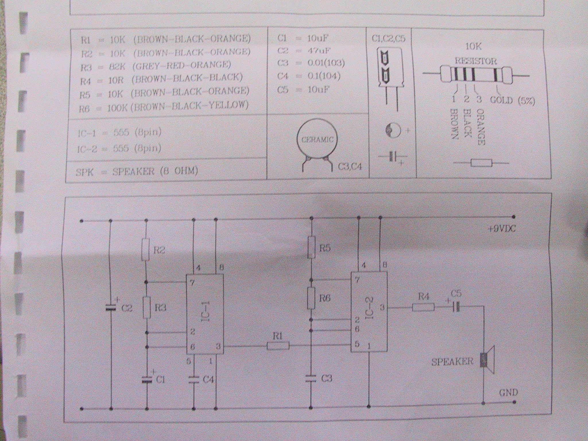

Im currently trying to simulate a siren circuit using multisim but no luck.
How do you simulate a sound using multisim? or is there any other software that can simulate a sound from a circuit?
Tq.
Please post the circuit.
I've used MultiSim in the past, but don't remember having the ability to simulate a speaker or buzzer. But that doesn't mean it doesn't. I've just never used it.
This is the circuit I try to simulate.
Can anyone try it and see if you guys can make it works.

There shouldn't be any need to simulate such a simple circuit, it will work providing you assemble it correctly and all the components work.

I don't think you'll learn much by having one of us run the simulation. Try to simulate it in LTspice. LTspice has a good help file.
If you get stuck, post what you have done (you can attach .asc files here, which are the LTspice schematic files). We'll try to help.

The circuit is silly for using two 555s instead of the dual 556.

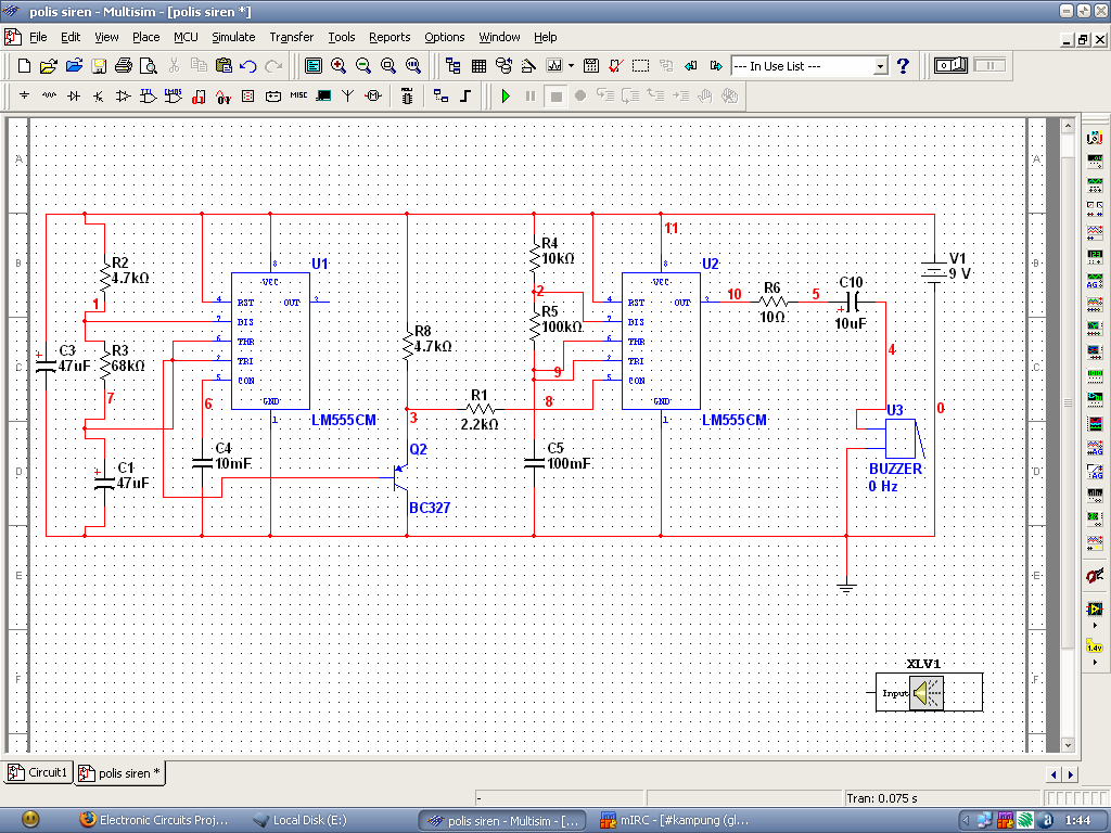

I put the buzzer and still no sound..
Maybe I wrongly connect the circuit in multisim?
I'm totally a noob..
TQ for your time and help.
You would learn a lot about the siren circuit by connecting an oscilloscope and seeing the waveforms, instead of simulating them.
Your new circuit is supposed to sweep the audio frequency up and down. The "buzzer" is supposed to be a speaker. It won't work with a buzzer.

I remember back when i was studying electronics, all I do is measuring peak to peak, watching the waveform changes by changing the time/div volt/div..
An oscilloscope will show if the frequency jumps from one frequency to the second frequency like sirens in Europe, or if it smoothly sweeps the frequency like sirens in North America. It shows if the wavform is a square-wave which makes a buzzing sound or if it is a sine-wave which makes a smooth sound.
If you want a sine-wave smooth sound then an oscilloscope will show if the circuit is clipping the top, the bottom or both which will make it buzz.
